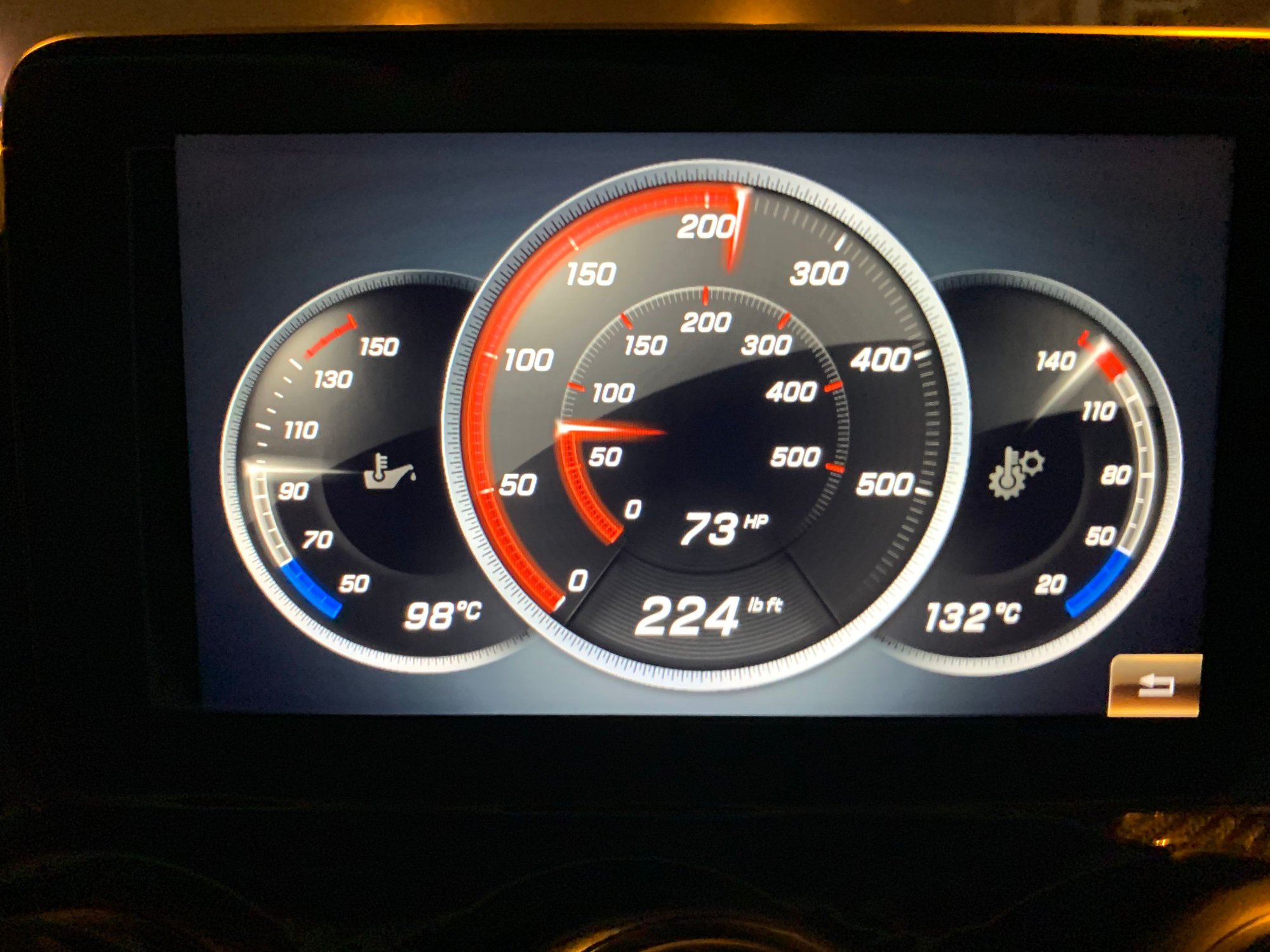

W205 : Mercedes c63 coupe 2018 - So I have got this mercedes c63 2018 .. When I am driving on a highway the gear temp is around 120 and when I am driving in the city due to traffic it reaches max temp 140+ is it like normal ?? Or its really risky to drive my car at this temp. You have a look at my snap. Thanks
Any suggestions would be appreciated !!!
As you can see the engine oil at 98 is ideal but the temp is way high at 132 !!!

You have a puncture in one or both of your auxiliary radiators. Read https://mbworld.org/forums/c63-c63s-...ad-debris.html

I concur, you've got a leak somewhere. That's way too high. Transmission temperature is generally around 10C cooler than the engine. The transmission is in normal operating range starting at about 48C and the engine at 60C. You can see the normal operating range on those gauges. Your transmission is in the red and overheating. There's protective mesh for all those radiators in the front, because they are known to suffer from rock damage. AMG fits them from the factory now on the FL models and there should be a recall or service campaign for older models.

*****You will roast that transmission very quickly at those temps. Leak in coolers or some other such problem. Regardless, get it fixed or it will get really really expensive assuming nothing is damaged already.
Good luck

Your IAT will be off the charts too :/
Like others have said, the dreaded IC heat exchangers get leaks.

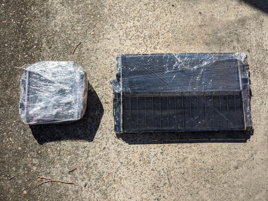

I've got spare ones
If you're in Sydney you can have mine for free I've got a whole set 2x aux coolers and a main radiator with the factory mesh protectors etc. ready for pickup
