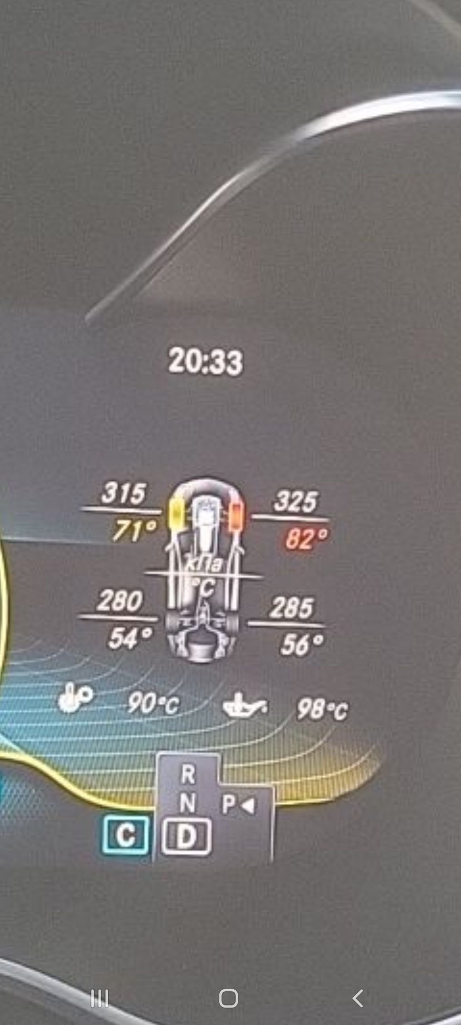

and next problem, the right wheel on the sensor heats up over 75 degrees Celsius. pads are normal. bearing too. What can be wrong??

******Brakes wise, I would flush the brake fluid well and disconnect the affected caliper from its mount, clean it well at the piston area, manipulate it a few times with a pad spreader to see if it is sticking. Sometimes, the caliper pistons get sticky from dirt or dirty fluid and do not retract properly. Also the brake line to the caliper may have some issue and have a weak spot in it for whatever reason and not be able to help retract the pistons. If you are handy, the calipers can be rebuilt, with new seals and the pistons cleaned with a crocus cloth or similar to remove oxidation or varnish, etc... The brakes will have to be re-bled well. More rarely, it could be a brake pressure distribution valve that is plugged or sluggish, but I would exhaust issues related to dirty fluid and sticking caliper pistons first as they are much easier to deal with. Water or air in the system can cause problems such as yours - proper bleeding and flushing can fix many problems so try that first.

For the brakes, the front right will always be hotter, there is auxiliary cooler on that side that heats the wheel well.

thank you but i check coolers left and right is hot all, why left tire not hot in normally ride?

and I also saw 2 pads on the side of the pad. I removed one shiny cover. stopped creaking. but the temperature got hotter. I think my wheel bearing is broken. but there are no loopholes. no more heating options. I covered the intercoolers with cardboard for testing.
friends how to walk the piston in the Brembo caliper (support RED ) easily or with little effort?
