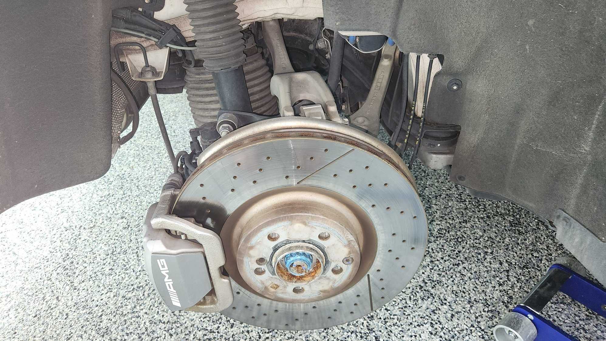

I ordered this exact kit for my lowered GLC63 SUV non S a few weeks ago, but I went to install only to realize the whole rear subframe has to be lowered a few inches at a minimum to clear the body so the inward bolts can be removed. I would double check yours to see if it requires the same. On mine, that includes the air struts so yours may be a bit easier. Not a hard job, so when my 11 year old starts his Christmas vacation next week, we will knock it out so he can learn. I'm running Truhart upper arms on the front, but this was the only rear camber kit I could find that matches my rear suspension set up. I'm not sure about the whole "S" meaning in the suspension differences, but mine is the SUV so definitely not an S. My GLC43 had a different rear set up like my C43 does, so the other camber kits would work.
