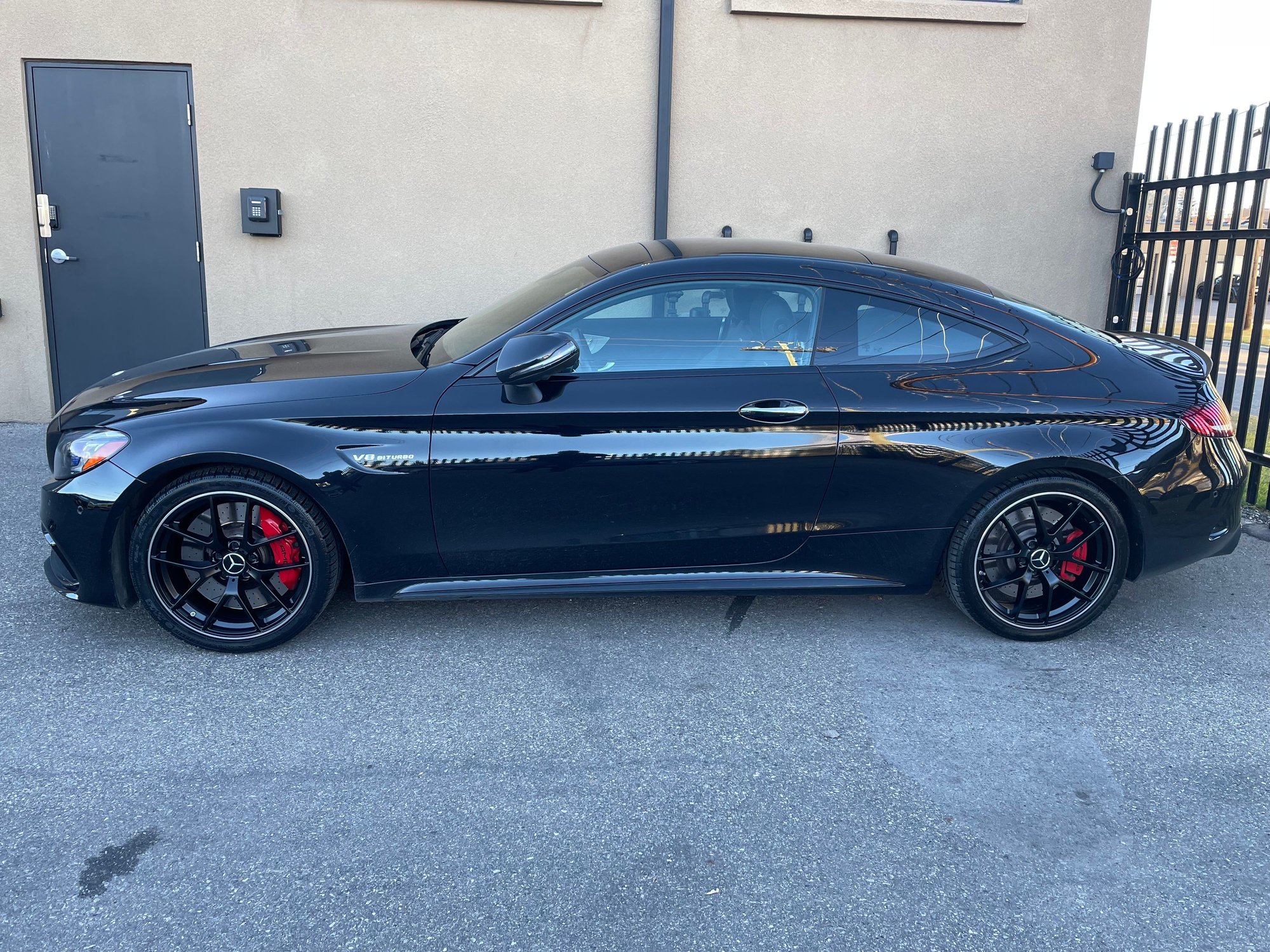

I installed 255/35R19 and 285/30R20 Pirelli Winter Sottozero Series 2 tires on my 2021 C63s Coupe in October 2021 and went through a winter north of Toronto last year without any issues. In 'Slippery Mode" the car handles well for RWD and I only got stuck once on my driveway that had 6 to 12 " drifts. Anything would have a got stuck that day, h
C63s ready for a white Christmas
owever, it would still be nice to have 4 wheel drive somedays. I mounted the tires on my 19"/20" AMG Cross-Spoke Forged Wheels and use a set of Avant Garde wheels for my summer driving with the original Mercedes tires.
