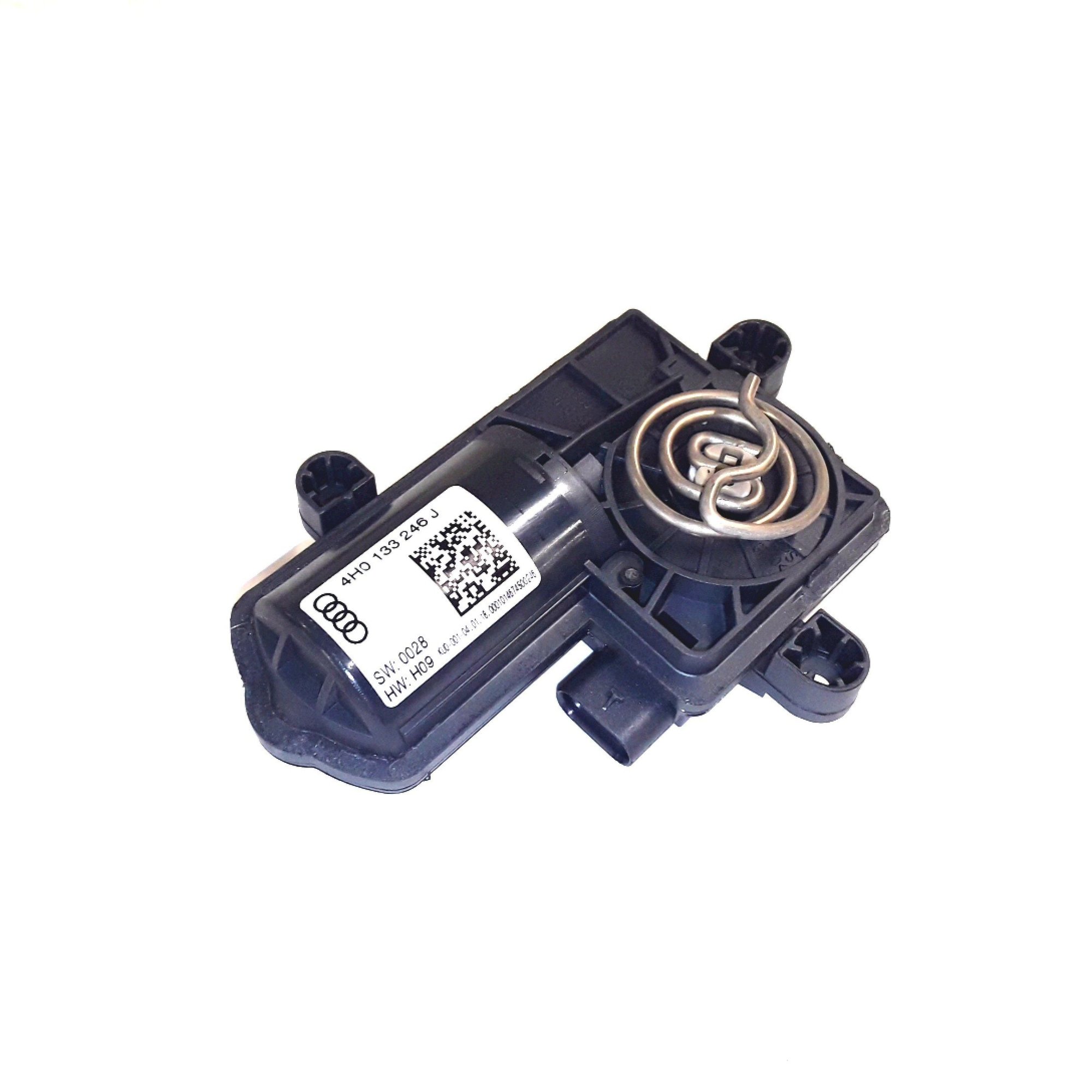

****Dunno which one is exhaust flap 2 but when I replaced my faulty actuator in the mufflers, I could see the flap was misaligned on the broken side just looking through the muffler from the back. The spring broke on the actuator and I bought a new one made by Audi that was exactly the same as the Benz part but less than 1/2 the cost. Ford also has the same actuator on some of their vehicles. Sometimes the Ford is cheaper than the Audi, or vice-versa - both of those are a LOT cheaper than the Benz one though, at least when I purchased my replacement..
The one at the H-pipe is identical to the others, but you can deduce that it is the broken one if the flaps on the mufflers open and close normally when they are energized. Easy fix. Oh. I also lubed the rod/tab thing thing with a penetrating lube on the muffler as it was noticeably more resistance to spin it than the other side - dunno how long that would last, but it did seem to free it up and make it a lot easier to spin so presumably less force on the actuator...
Good luck
