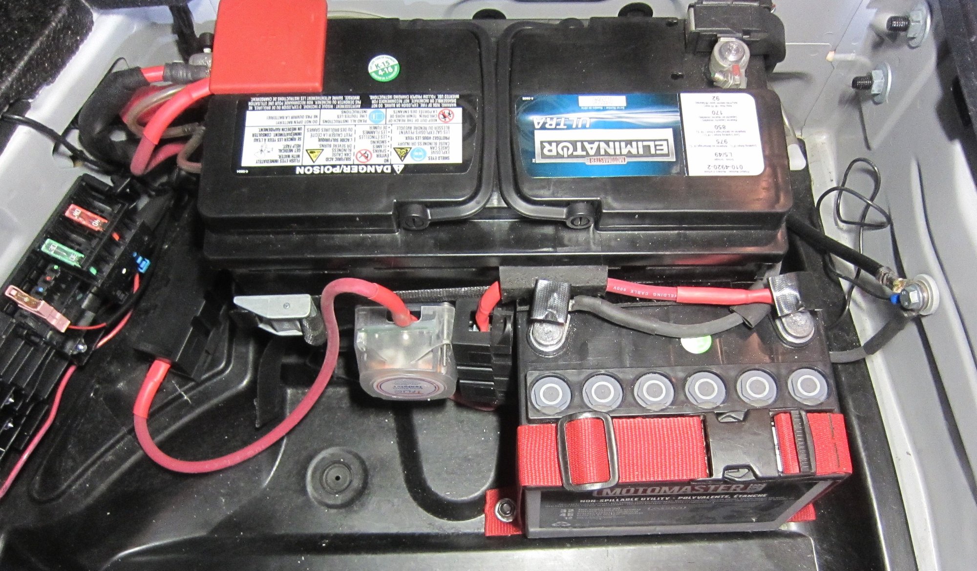

Letting the dashcam drain the battery down to 12V is too low. I had the attached document squirreled away but don't remember where it came from.
If you use the parking mode on the dashcam(s), you might want to invest in an auxiliary battery setup using a voltage-sensitive relay to isolate/connect/charge the aux battery. I did this with my C63 S and I've attached the circuit diagram, in case you are interested. I used a multi-safer switch because the dashcam didn't have it's own/built-in low-voltage cutoff, so you could eliminate that part.
