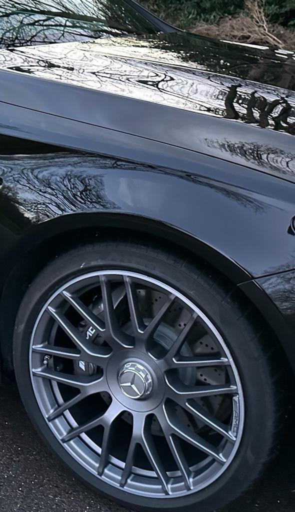

That's interesting. Any pics of how it sits in the arch?
How did you find it vs. the (I think) original 245 / 35?
Old Jan 30, 2023 | 05:33 AM
Fordgt40's Avatar
Joined: Aug 2011
Posts: 220
Likes: 17
C63 amg esate
The ride quality is a touch better, road noise is quieter but that could be because the original Pilot Sport 245/35 were worn out.
Yes I know it could do with a wash but I’ve been very busy and somehow never got the time.

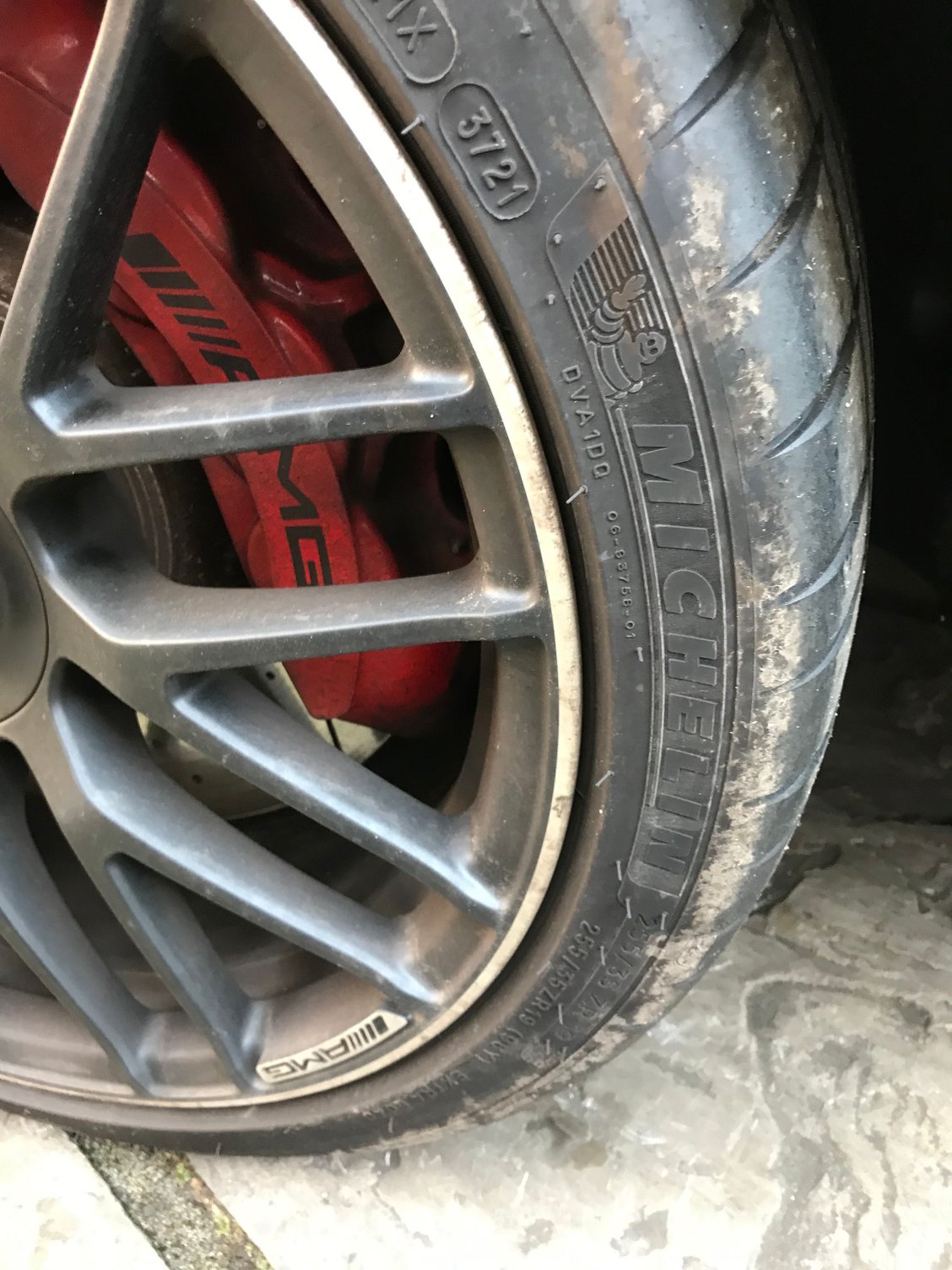

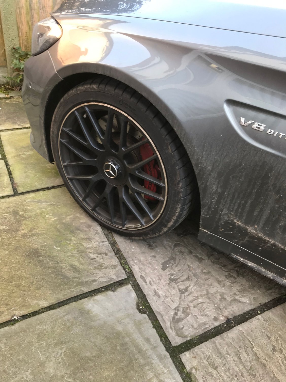

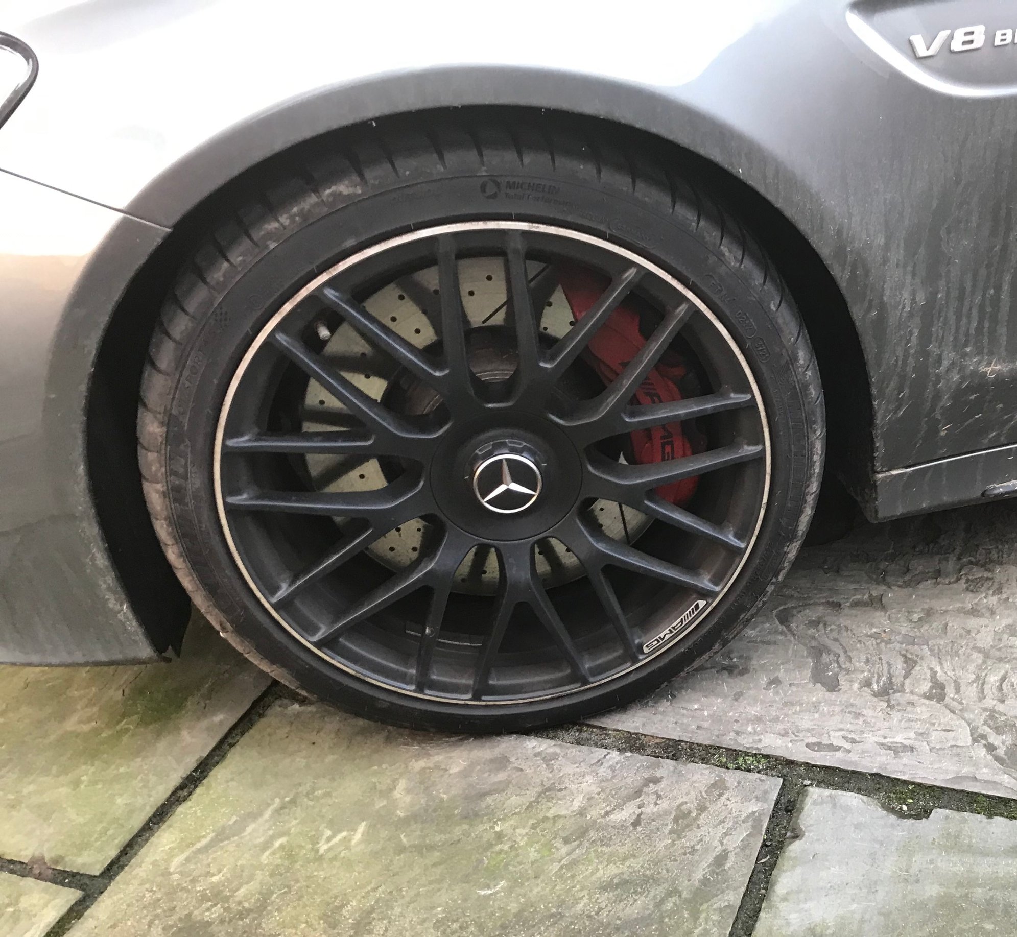

The current front is a Pirelli with a rim protector, see picure below. It certainly doesn't look too narrow for the wheel, but I think this could partly be the Pirelli protector design which sticks out quite a bit!
In the end I have decided to stick with the factory size tyres and have ordered a set of Michelin Pilot Sport 4 S which I have read great things about all over the internet. It should hopefully be a nice upgrade on the Pirelli front and Falken on the rear, which for some reason the dealer fitted just before I bought the car. They are brand new!
