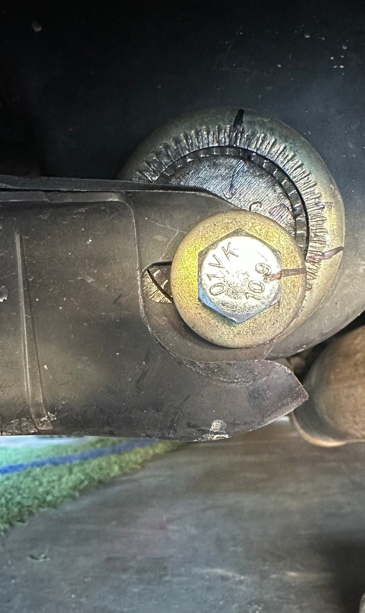

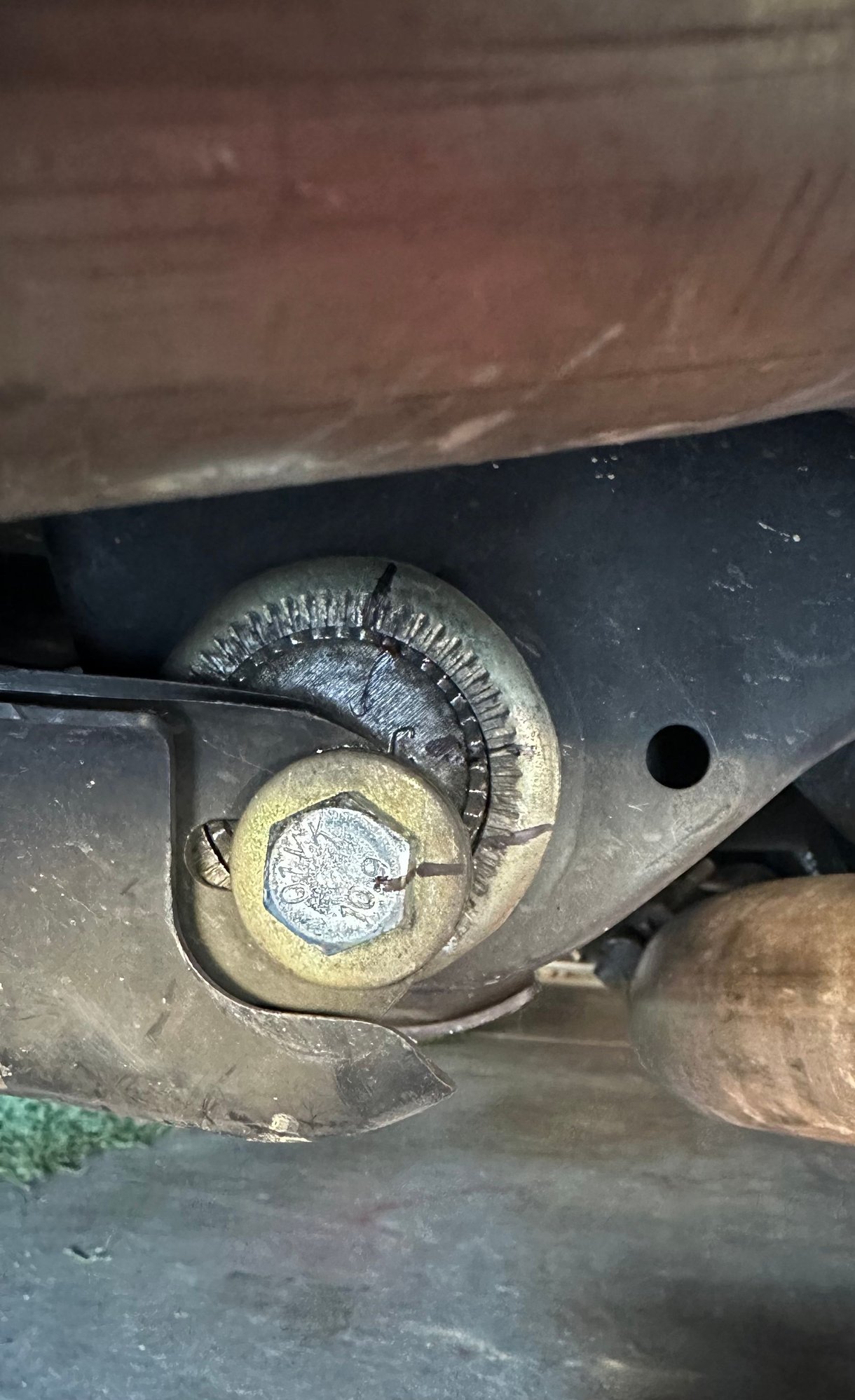

Hello Everyone,
Has anyone had problems with the KMAC Rear kit slipping. Ever since I’ve had this kit it hasn’t helped with the inner tire wear even after two alignments. My alignment place did some investigating and noticed the Camber bushings are not holding their positions. You do the alignment and as soon as you drop the car the camber is off. One thing they did was torque the control arms to an 110 ftlbs which is higher than 77-95. They slipped again so we decided to replace the grade 8 bolts to new ones and retorque them to 110 lbs. I drove home and same thing happened again.Here are some pictures of the left side showing it slipping. I’m not talking bad about K-MAC because the front kit is working great, but the rears are causing me more money in tires and alignments than just having OEM bushings. Any advice would be helpful because I am unable to fix this problem.

Exact same thing happened on my w211 E55. Kmac in the front was outstanding. Kmac in the rear was nothing but a continuing source of frustration until I reached the point I removed the kmac bushings and reinstalled stock bushings.
Like you, I removed the 12 mm grade 8.8 bolts and replace them with 12 mm grade 10 bolts and torqued down to 110 foot pounds. No joy as the damn thing slipped out of alignment in less than a day. The alloy control arms are very soft and the metal literally flows/scrapes/deforms under the pressure of the steel teeth of the Kmac kit. When the bushing slips it kicks the toe of the rear wheel out and the car becomes extremely unstable. I will happily recommend kmac bushings in the front and I will emphatically not recommend kmac bushings in the rear.
It's a shame as the owner of k-mac is a nice guy and really trying to come up with a good design. After, however, the third iteration of the design on my car and it was still failing almost immediately each time, I pulled the plug and pulled the parts.

Thanks for the reply. So basically I’d have to replace the control arm and KMAC bushing and hope it works. I was trying to not be cheap and find a solution for longevity, but for what I paid for the kit would have almost covered a set of rear tires. I got a year out of the tires with the Oem bushing so I’m not complaining. Guess I’ll start looking for the Oem bushings. Atleast then I don’t have to worry about it slipping and giving me extreme camber.

Advise address and will forward replacement bush.
Design has been in production since 1993 (30 years).
Constantly proven "in all out heavy V8" - Competition racing.
Eccentric adjuster and time of alignment bushes must be fully tight 100ft/lbs (135NM).
As stated on instruction sheet: Essential / Recheck / Make Sure 2 Nuts Are Fully Tightened (Loose Nuts Cause Noise, Noticeable Camber Change).
What has happened here is initially not fully tight - the hardened teeth have rounded - No longer can clamp (there are 4 clamp areas internal and external).

Wow … that look scary. The oem used a locking plate to prevent slipping. This is a different design
