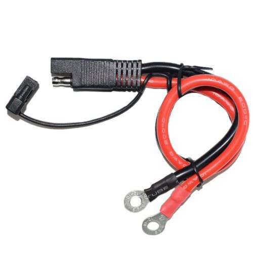

What others have done is install an O Ring adapter that's long enough to run it to the other side of the car or hidden behind the grill, so you can then easily connect the trickle charger. Another option is a 12V socket adapter, but those only work if you have an unswitched 12V socket in the car. I don't remember, but the one for the rear passengers might be unswitched.

Since the C43 was parked so much during the pandemic, I installed a charger plug, wired directly to the battery terminals (via a fuse, of course). We continue to use it if the car will be parked for more than a day or two, just to help extend the life of the battery. I used parts available on Amazon and installed the socket in the lower part of the front license plate. I painted the rubber socket "lid" using the factory touch-up paint and it adhered very well.

on my 18 C63s (sedan) i have it hardwired to the battery in the truck similar to o-ring adapters above - keeps the battery nice and new all winter long -
