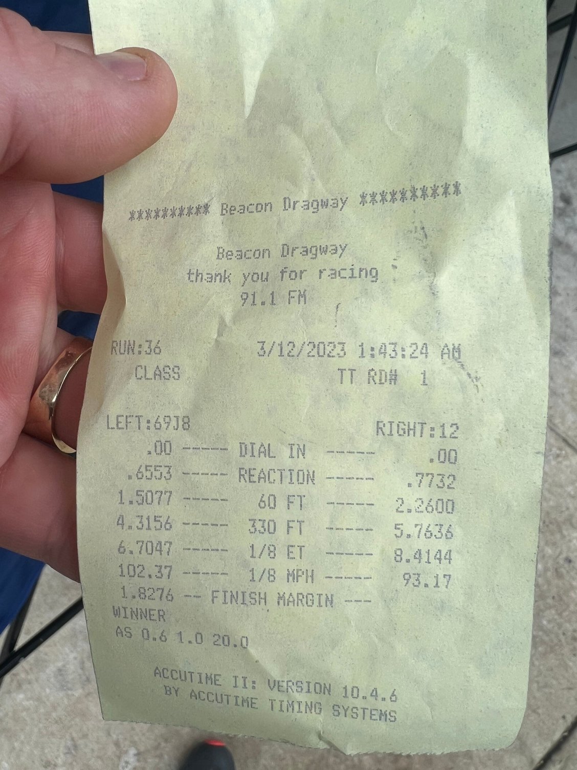

1st Run- 42psi tires, no burnout, Sport+, power brake to 2000rpm, ran a 8.41 @93mph. Reaction .77 60ft 2.26

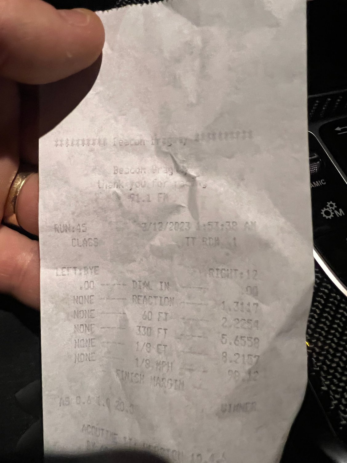

2nd- 38psi tires, turned traction off but couldn’t get it to burnout (user error?), Race mode, power brake to 2500rpm, ran a 8.21 @98mph. Reaction sucked 1.3 60ft 2.21

I'd say your 60' time being so bad is the problem, but I would expect you to be running faster times with those mods. I am not sure what that setup should be good for, but the bigger turbos could be limiting your low end power as they spool? On an 1/8 mile track you don't get to really open it up on the big end of the track. However, you did end up trapping 98 mph in the 1/8 which seems decent. The 93 mph runs are odd as that is about what my bone stock C63 (non-s) did when I went to the track, albeit on a 1.85 60'. Link to my post on my 1/4 data
Do you have a way to data log your car? If there is a problem you may not be able to diagnose it without some data for your tuner to review.

good points, I know the timing was abysmal. They had a new tree that had a different rhythm than I am used to running so it just felt weird. As for data logging for the tuner I have an Autel that will do the trick.
