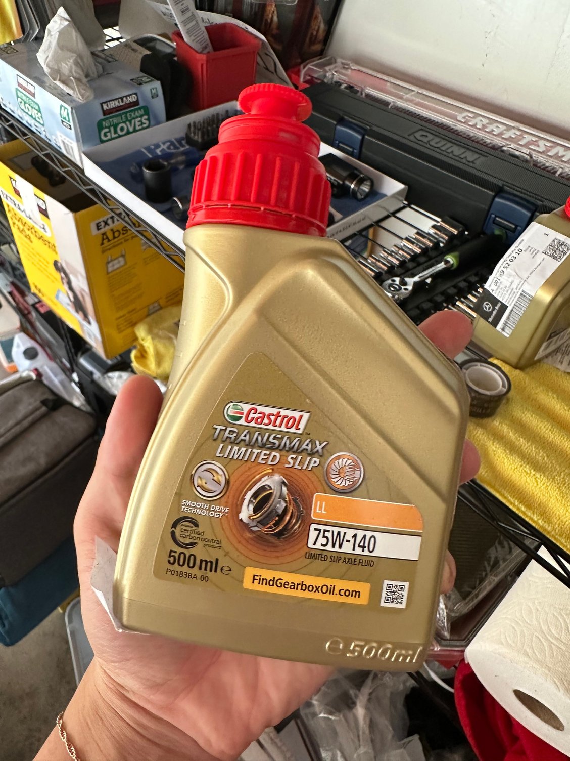

I used castrol 75w140. 3 bottles so roughly 1.5L and you will have left over.

Originally Posted by japamg
Castrol bottle is 1L, how is you used 3?
My bottles were 0.5L each.

Old Oct 22, 2023 | 12:03 PM
mokawop's Avatar
Joined: Jul 2020
Posts: 181
Likes: 21
From: Arizona
c450
Old Oct 22, 2023 | 12:24 PM
You got any error code? By removing sensor or whatever…
Thanks
Old Oct 23, 2023 | 07:01 PM
mokawop's Avatar
Joined: Jul 2020
Posts: 181
Likes: 21
From: Arizona
c450
No codes or issues after the change.
