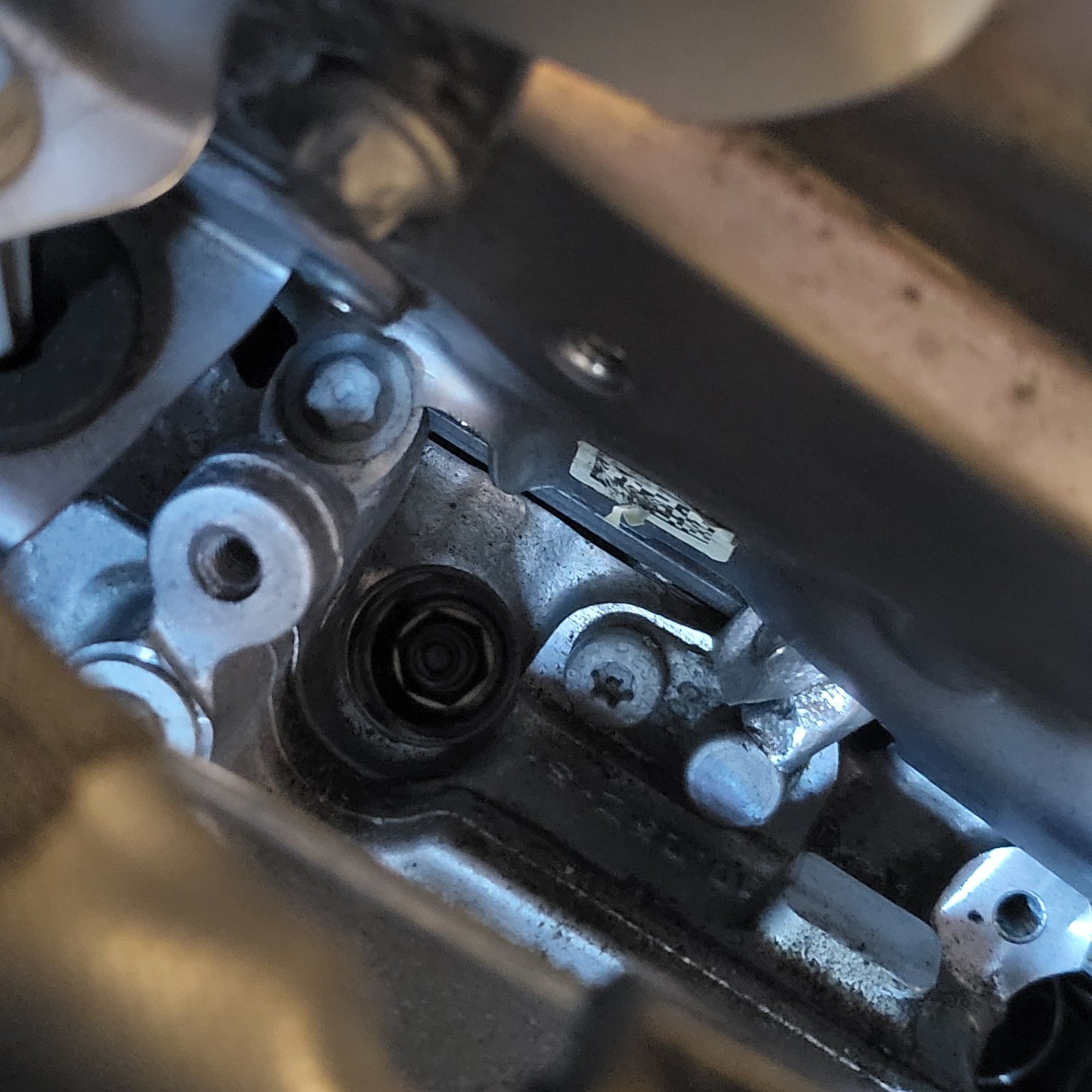

I thought this wouldn't be too difficult, but I've tried 2-14mm deep sockets. Neither one will grab the stock plug! 1 was a 12 point too. I ordered an extra deep socket that is coming tomorrow morning, but I fear my plugs are wrong as the sockets I've tried on the car DO fit the plugs I bought, so I'm worried the plugs I got are shorter than the ones in the car.
I bought Mercedes Benz A 000 159 05 00 plugs.
The plugs I got are branded Mercedes Benz.
Any thoughts?

I've just recently done my spark plugs. I think the part number is correct. That's the same one I have used to order them.
I'm not sure, if I got you correctly, but I think the outer width of the socket could be an issue. It has to be pretty narrow.
Do you get the plugs currently in your car out? If yes, you could just compare them. If not, I think the socket could be to wide on the outside.

It's a thin wall, deep 14mm spark plug socket.
I could NOT get the old ones out.
I've tried 3 sockets now and they're not working.
This is NOT my 1st spark plug change, but it IS the 1st time for this car.

Why can’t you get them out? I used a 5/8 spark plug socket and it gripped them fine.

Good question! It almost feels like the socket is not deep enough and the tip of the spark plug is bottoming out in the socket before the socket grips onto the spark plug..if that makes sense.

Do you have a picture of your spark plug wells? Maybe that could help. Here is a picture of mine.
