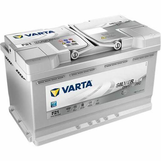

I replaced my prefacelift coupe battery myself two years ago it's very easy once you lift out the boot carpet but I'll be honest I did it the lazy way and didn't reprogram or reset anything just swapped it out and haven't seen or had any problems yet.
As soon as I put the new battery in the car started quicker, start stop became available faster and no settings or tune were lost at all.
Connected the scanner and had no errors.
Varta F21 for start stop vehicles is the OEM replacement for coupe.
