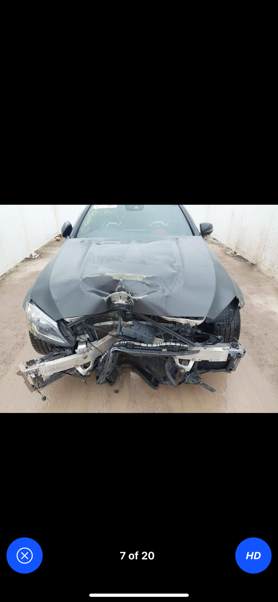

Recently bought a crashed damaged c63s from Copart, steering wheel & knee air bag deployed and bonnet. When the car arrived before doing any repairs we managed to squish back in the pyro fuse and got the car started so we proceeded to continue with repairs including all front end rad, pulleys etc. we are getting to the end of repairing all the broken pipes and have now topped up with coolant and oil and have now gone to start and we have nothing.
