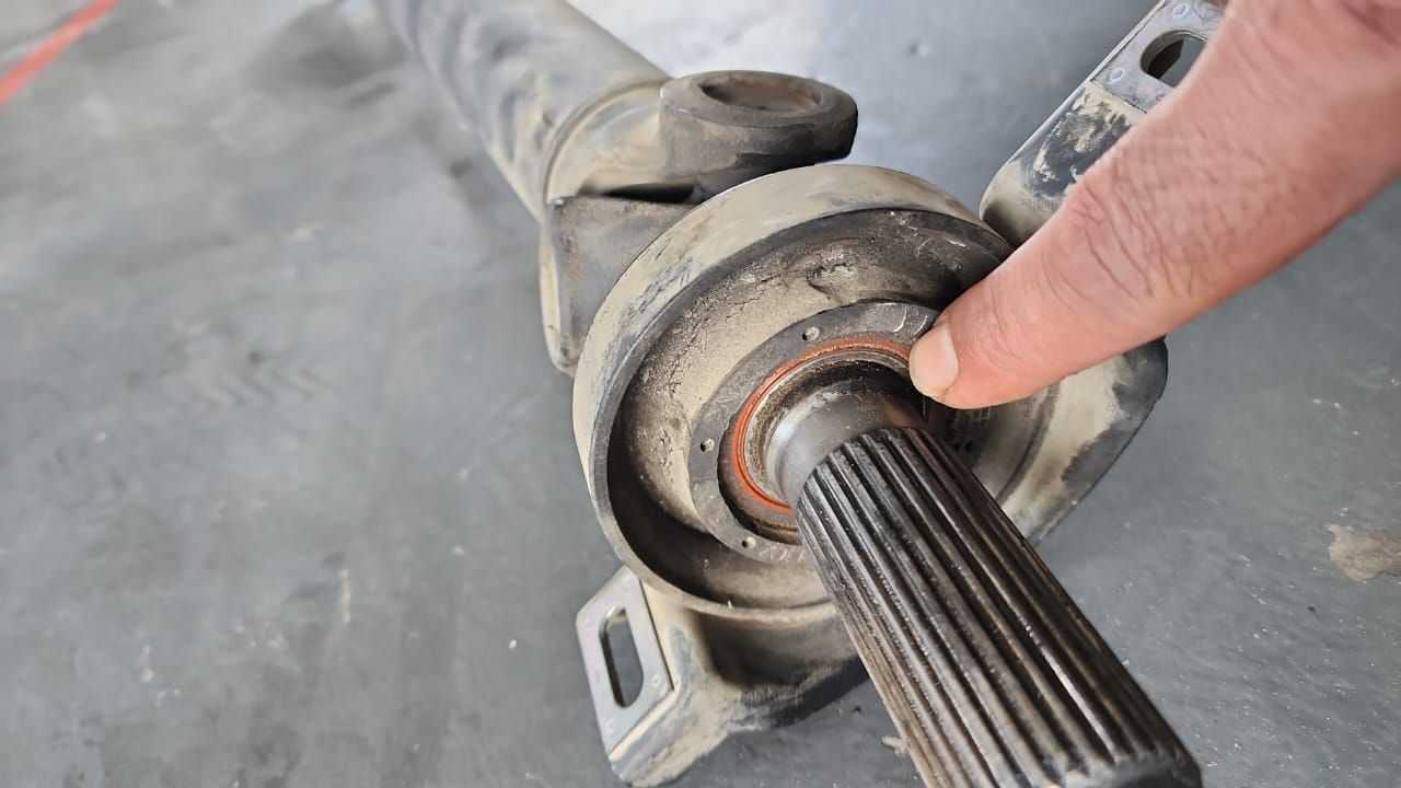

It kind of sounds like the driveshaft center support bearing has gone out. Or another possibility could be the driveshaft flex disc’s are broken. It definitely sounds like it’s coming from the driveline

You were kind of right. The center support bearing was broken. I changed the center support and rubber mounting as well while I had it out.
Surprised it was the bearing and not the rubber bushing as it created a lot of noice, but apparently the bearing is fully capable to make these noices by itself. Even with a healthy rubber bushing.
