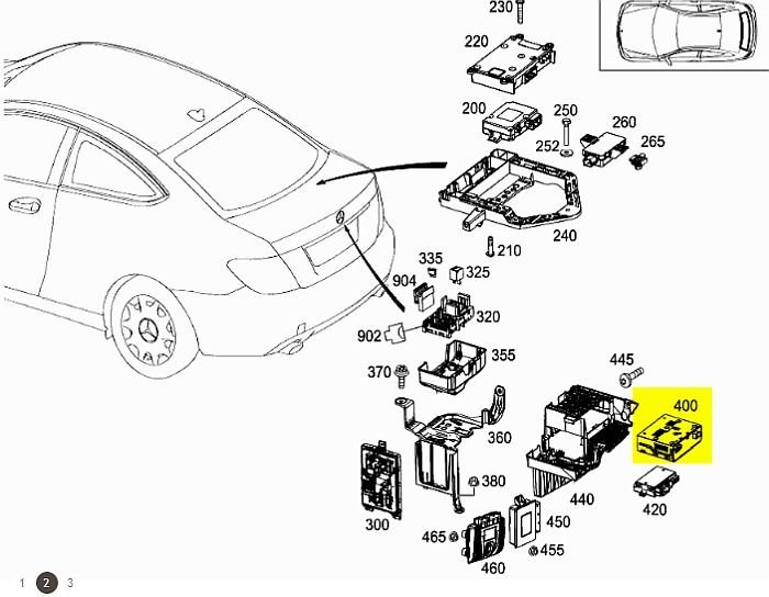

Hi Doc, according to the parts catalogue it's in the boot. There's a few versions but part number is A2229009011 (for prefacelift it's A2229008002)
I've highlighted it in yellow. Here's a few pics are you able to find it in the trunk behind the liner and carpet?

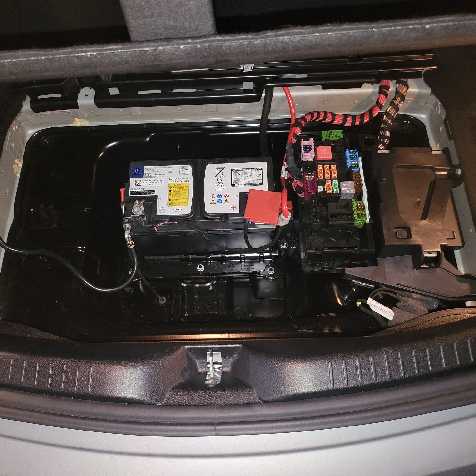

So this is my trunk space..battery and fuse panel. To the right of the fuse panel, under the flat black plastic part feels like more electronics or fuses only..

Nope it won't be there. Unclip and pull back the carpet that lines up the sides of the trunk. You'll see round black clips that secure the carpet that pops off.
Pull back the carpet what do you see on the sides?

Well, as luck would have it, the bolt on the driver's side was stripped and could not be removed.
I pulled the carpet back a little on the passenger's side and didnt see any components.
