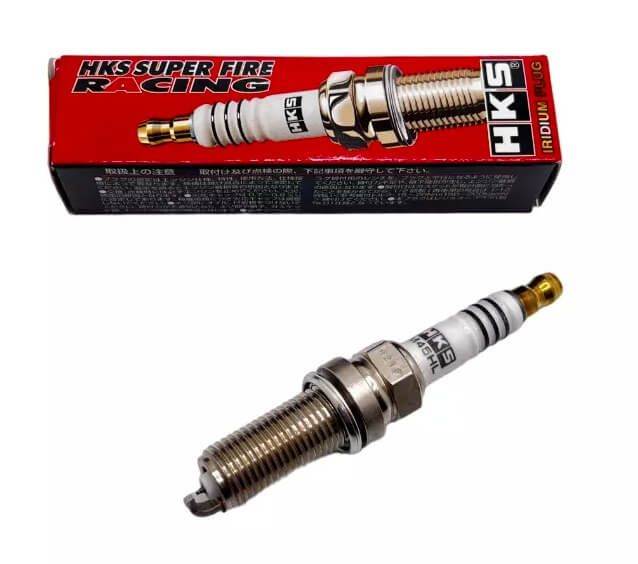

HKS
Originally Posted by deanoo
Currently running a stage 3 setup on my 2019 C63s and have been for a while, stage 3 consists of PTG turbos with methanol injection
Wanting to do a spark plug replacement as i can hear a slight missfire on idle
Ive been told the NGK stock replacements are fine, i have also been told the HKS one step colder is also fine but they do tend to cause missfire issues
What plugs do people with a similair setup run?
HKS 1 step colder. At idle I notice the odd "thud" every now & then in the revs if I switch off the a/c and sit in traffic after a hard drive but never had a CEL or proper misfire with HKS plugs Stage 3 for almost 3 years now.

M45HL. If you’re running high e content, you can run 2 step colder M50HL. I run the 50’s with e50 gapped to 0.025 with no issues. Logs are good.

M45HL
