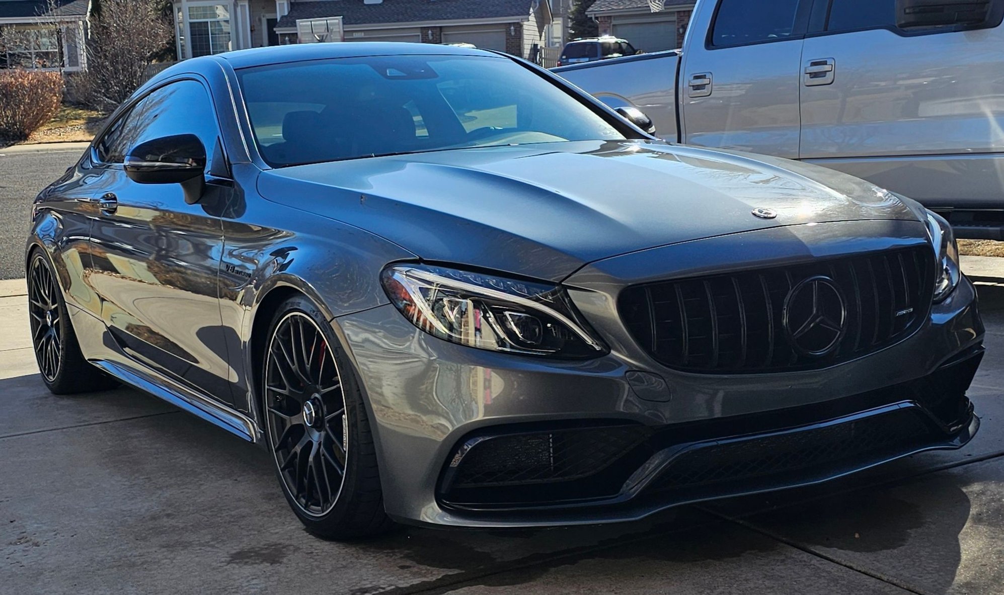

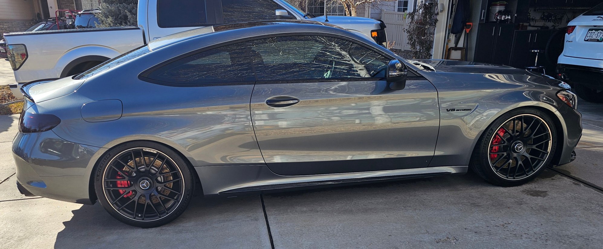

I am running Michelin PS4S 295/30/20 in the rear, and 265/30/19 in the front with H&R lowering springs and KMac camber bushings... no rubbing at all.
OP has a sedan. The coupe accommodates wider wheels/tires. I have to say that front wheel looks very awkward, though w/o camber and tucked in so far. The fender sticks out way past the wheel at least from this angle. What do you have now? 0 degree camber? That's fine for straight line driving, but not if you like to corner. Definitely lost some aggression on the front. The rear looks fine.

"0 degrees camber" ... Wow. Yep, you got it. 🤦‍♀️
