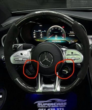

Helllo guys, im new here!
i have c63s amg coupe, 12/2019
On my steering wheel the round button for comfort/sport/sport+ mode is not working at all and also the left button for exhaust valve …
i had my car detailing cleaned…maybe some liquid went in the electrition?
and also my battery 12V is partially charged..can this be the reason maybe?
This buttons dont work…
Thanks for help guys!

That looks like the AMG Drive Unit control module died. Has happened even on brand new cars for some and they needed the module to be replaced. The 12V battery partially charged is not unusual. Mine is in that state most of the time, unless I hook it up to my battery tender. However, I think my battery is on its last leg at his point. My car is a 2019 as well and AGM batteries are pretty much done after 4-5 years. My instrument cluster has started to have some gremlins and I suspect it's the battery. I don't drive my car a lot and especially during the pandemic the battery probably sat too long at a low charge level. I have two battery tenders and my older one had started to indicate a battery fault a couple of years ago. Bought a new one that has a repair mode and it charges the battery w/o error, but I think the battery is probably bad. I've got my regular service scheduled for January and also have an appointment shortly after at my indy to figure out what the clicking noise is about in the front axle during parking lot maneuvers and I'm planning on having them install a new battery at the same time before I troubleshoot the instrument cluster issues any further.

Mine went out on the left side a while ago, the buttons still work and the screen still light up but just no graphics. I think I will try to clean the connectors to see if that fixes it, if not I will take it in before the warranty is up.
