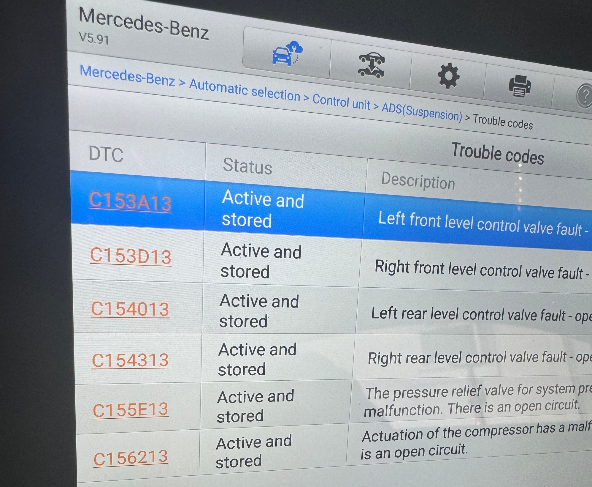

Water/moisture had gotten into my suspension control module that’s located underneath driver seat causing it to fry the module. Suspension fault aswell as no communication to system.
Purchased a used module, hooked it up and now I’m just have a suspension fault on the dash but able to communicate with the system.
Car is no longer stiff but the COMFORT and SPORT setting is the only option available, it won’t even recognize SPORT +.
I attached a photo of the codes below but from what I know is that the car does not have a pressure relief valve???
im trying to avoid buying a new module and having it dealer programmed.
would greatly appreciate any help or pointers
