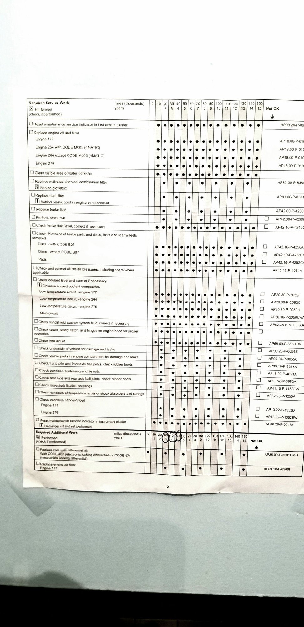

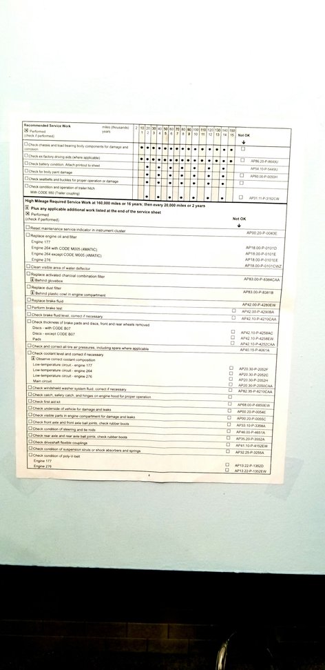

Below is photos of Mercedes Benz required Service sheets for miles (thousands) or time.
My 2019 C63s coupe is coming up for 6 year Service which include Service B and full Transmission fluid and filter change. My car has about 33,000 miles.
My previous Service B at the Dealership did not include replacing the engine air filter (every 3 years or 30 000 miles)) and differential oil change (every 3 years or 30,000 mile) as required by the MB service work
sheet. I had it done at addition cost.
Service B should include replacing both the Dust filter and another under the glove box.
Wiper blades.
