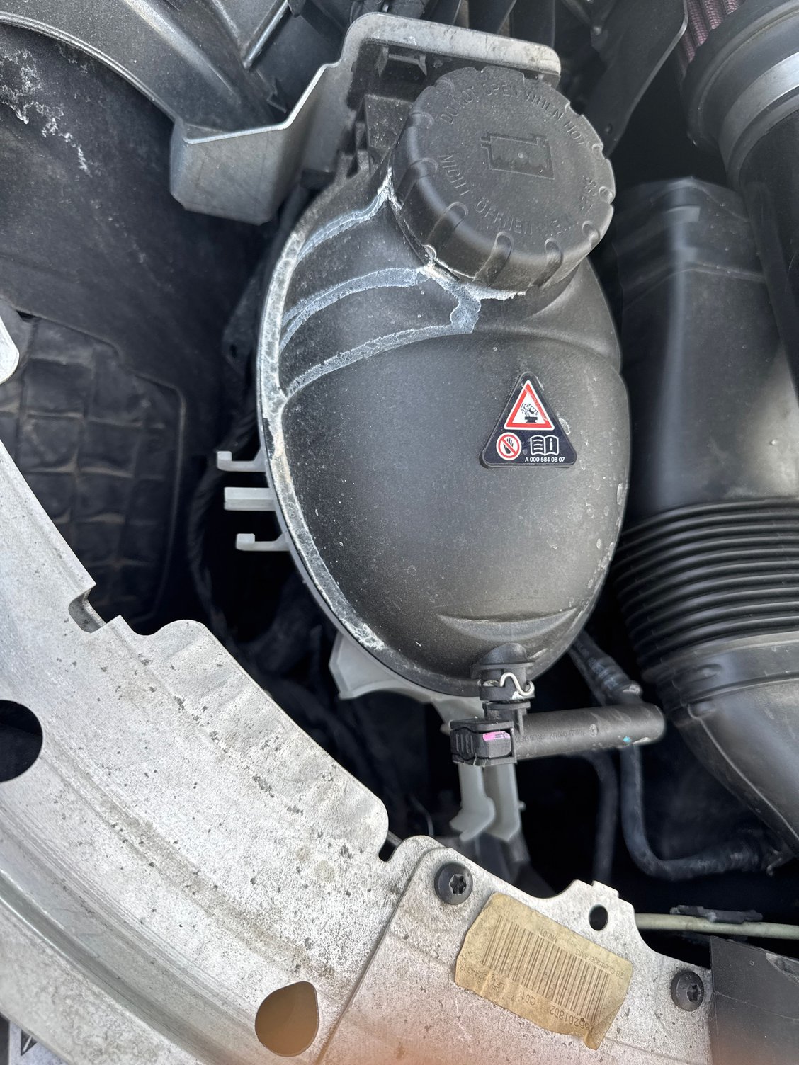

checked coolant tank and looks like it over float?
https://cimg5.ibsrv.net/gimg/www.mbw...cc536291f7.jpg
Replace the cap, I forgot if there was a superseded part number but a leaking coolant cap on the W205 was relatively common.
Did you replace the cap as well?
no, but my mechanic is saying i need to get new water pump
