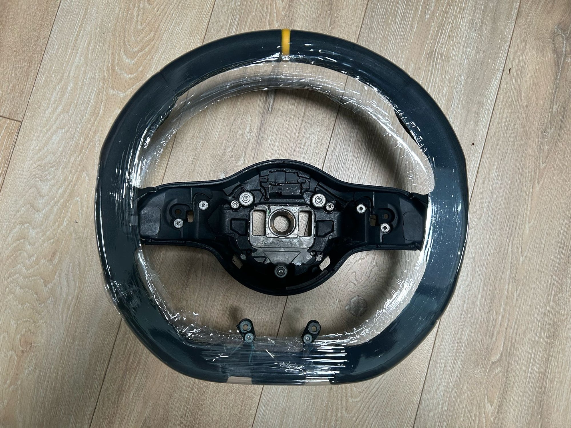

Hi guys
Get any codes or something when you replace your steering wheel with same OEM model? I guessing airbag would trigger some code?

I don't believe so. Airbag is separate. New steering wheels come w/o airbags, so you would transfer the existing airbag to the new steering wheel and if it's the same exact steering wheel no coding or adapters would be required. Should be a straight up replacement.

The yellow thing was peeling off I cannot live with that 🤣
As it will happen again in the meantime I am getting mine customized with alcantara and matte carbon fibre matching the central console 😎
Its normal having two steering wheels right? Hahahah
