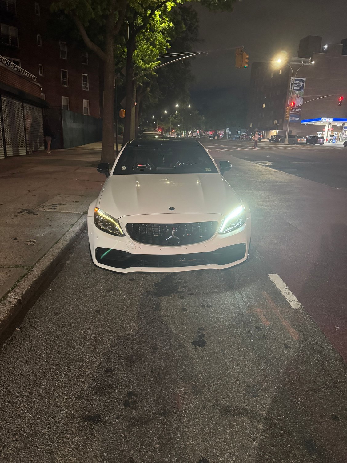

Hey guys,
I just purchased my car 2021 c63s and after just a few days I noticed that my left headlight LED is much brother then the right one.
it seems like the light is dimmed and not as bright as the left one.
any ideas as to why it happening and how can I fix it.

In the picture it looks yellow. Is it yellow in person? White LEDs turn yellow when the phosphor coating that's responsible for the white visible light degrades and changes color. This happens naturally over time, but if it happens prematurely, then the LED was exposed to excessive heat and is basically toast.

LED is cooked, do you have PPF installed by the way?
I do have front PPF, the car was under the sun yesterday for a meet. Do I need a new headlight or they can replace just the LED ?
yes it was under the sun yesterday, I was at a meet and maybe it got toasted.
Do I need to replace the whole headlight or just the LED?
Whole headlight replacement. PPF installer heated it up too much
so I should remove the PPF for the future?
No. Find a better PPF installer for your new headlight.
Whoever installed the PPF has heated your headlight too much and ruined the DRL.
