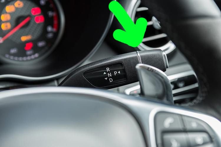

I had that too. I started to push my cluster with my hand while driving on the freeway as it was driving me nuts.
After hours of sticking my head around while shooting down a rough freeway (don't do that) I found out it was this flimsy little silver trim on the transmission stalk which clicks around. So I pulled over, stuck some tiny fluff hairs I picked from the boot liner into it with my finger nail until I managed to get felt ***** from ebay. It damn near drove me crazy.
