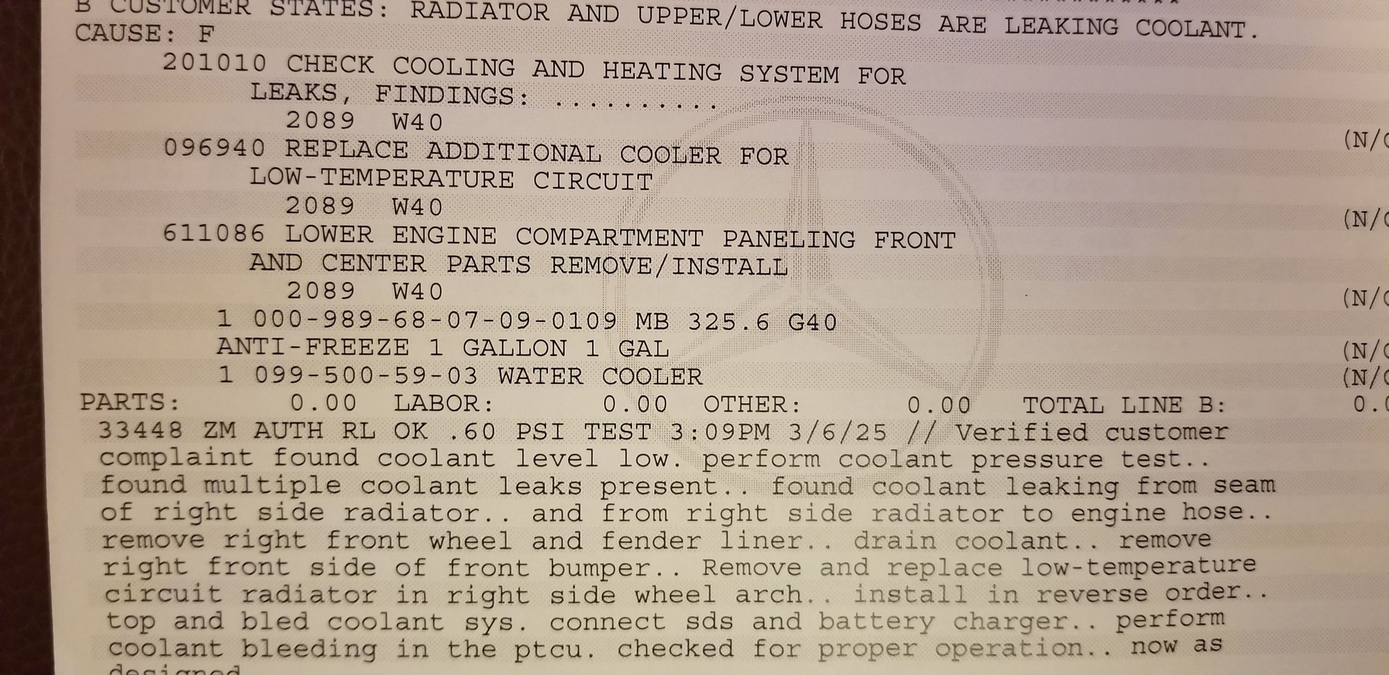

Don't know if it will help but see MB Invoice below. They had to replace my right side radiator. In doing so REMOVE the right front Wheel and fender line then right front side of front bumper. Then install in reverse order.
thanks for this
I think this may be the culprit and why theres lot of resistance cause thos fenders arent lighibg up properly its broken inside.
