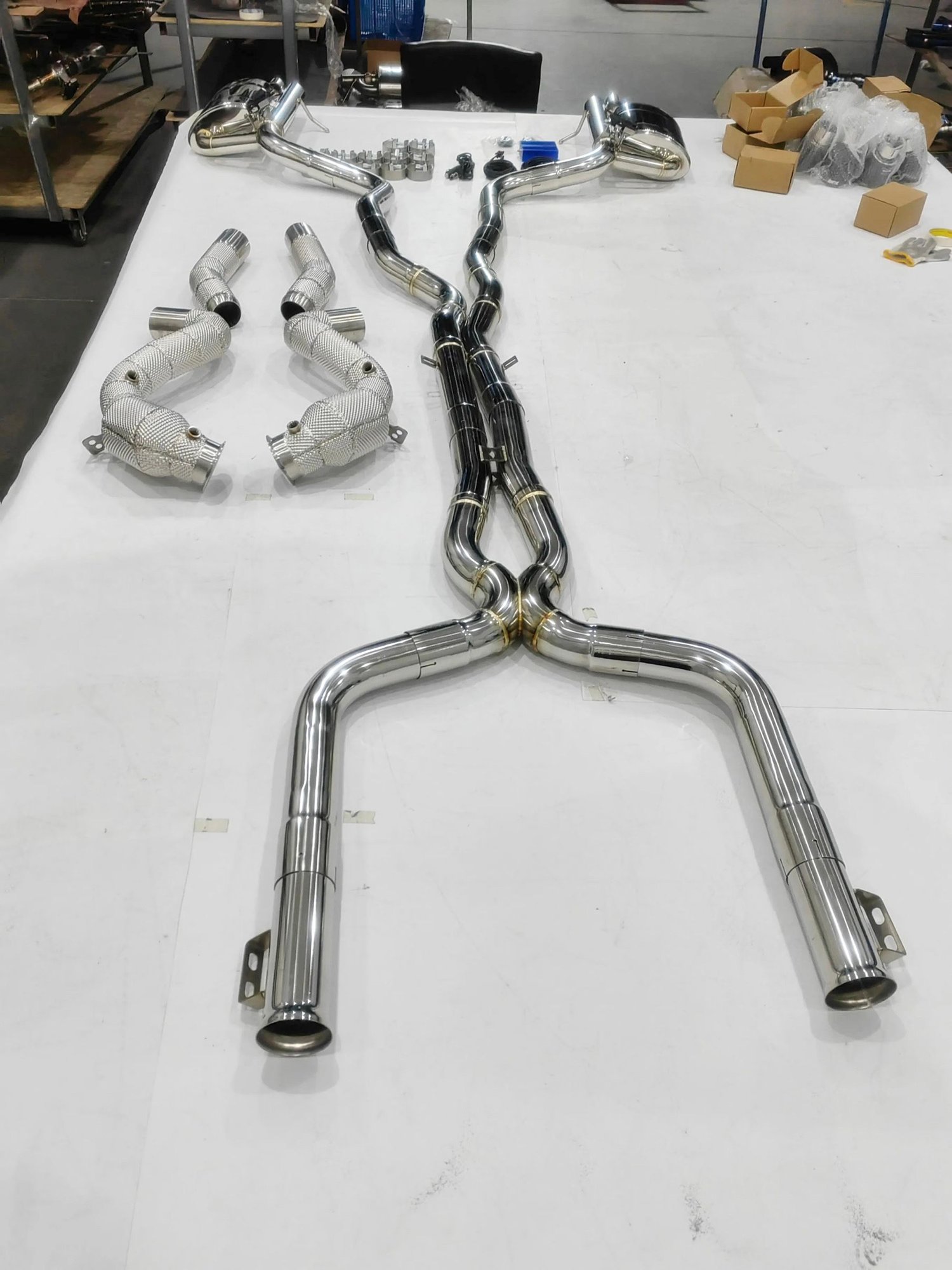

Hi I've talked to my mechanic about doing a muffler delete on my c63 w205 2016.
Currently I have a after market valvetronic exhaust (attached in this thread) setup but I heard my friends 2018 c63s with muffler delete on stock amg exhaust which sounds louder and beefier.
Both my mechanic and my friend have told me that I will loose power when straight piping my car because cutting the mufflers does something - not entirely sure but he said a emulator is needed to tell the car there is mufflers on the car.
Also on current setup, stage 2 tune I shoot flames, I've attached a picture a quick picture of the flames but they are huge when they come haha. Is this because of the valvetronic exhaust or because of the tune? If I was to straight pipe with AMG exhaust would flames still come or is the AMG exhaust restrictive ?

The flames is from the tune, a exhaust will not affect your car making flames or not. I only have the primary cats in my car, I got a secondary cat delete and the AWE track exhaust which is basically a muffler delete and slightly larger diameter pipes. Your mechanic is somewhat correct, you will lose some low end torque/HP because the mufflers help create some back pressure, and with them gone, you will not have that pressure. The difference is very very negligible and will not make a difference though. You will not feel the loss in power and I'm sure when you race you shift at redline instead of 1500rpm

not 100% correct. Back pressure is a thing for NA engines only. No need to worry abt that with turbocharged cars.
ps when i had my c63s i did secondary cat delete plus awe track exhaust which is a muffler delete. I wasnt a huge fan because of the drone and after some time I put in the mufflers back. I would rather get downpipes than do a muffler delete imo.
