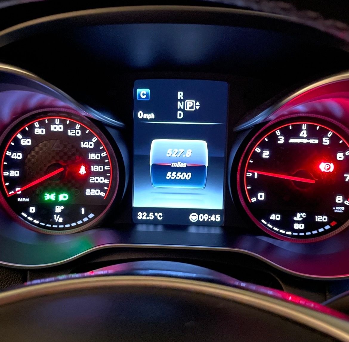

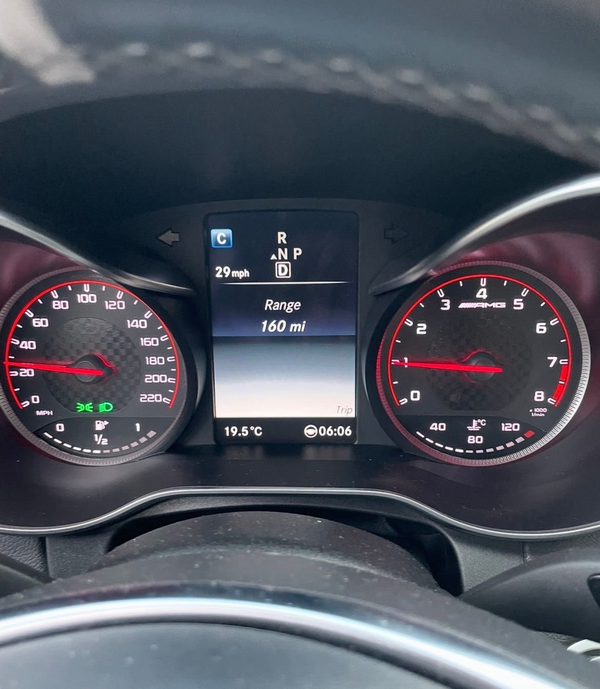

I don't know what the 220 vs 200 on the instrument panel has to do with your car issues... All the C63's I've seen have 200mph on the speedo. But now I'm curious... Post a pic of yours.

Yes, most w205s top out at 200 mph but mine tops out at 220 mph. I believe the governor was removed during build as well. Cold start slipping was happening prior to the dealer replacing trans fluid. Cold starts are still slipping after trans was serviced and yes was done by MB dealer. They filled it properly and people have stated that slipping on cold start went away after wet clutch was replaced but wanted to confirm this. If that's the case in my opinion its NOT normal for cold start slips unless replacing wet clutch doesn't fix this.
I know the rear brakes are dragging because they get hot after driving and is hotter than front rotors. Also, in neutral the car stops rolling freely on a slight hill and yes rotors are taking a beating. Glazed slightly and driver side is now producing an outer lip due to excessive dragging. I'm suspecting caliper is seizing under heat which is most likely scenario at this point.
Sliding pins are NOT supposed to be over lubed as this can cause pressure between the sliding pin and the end of bracket bore. Excessive lubricant will cause the pins not to move all the way down and prevent them from moving freely. So again, don't over lubricate sliding pins as its well-known this isn't good for full range of motion of pins. If you get away with it fine but it's not recommended to over lubricate slide pins as it can prevent full caliper movement or cause pins to back out slightly. Yes, I use Permatex silicone extreme brake parts lubricant, and I suggest you use the same.
Lastly to bleed the brakes or open the bleeder screw you do not have to remove the parking brake actuator. You need to retract the parking brake using a scan tool or follow diagnostic brake pad replacement window (hold and press ok and home on steering wheel). This will retract the parking brake and allow the caliper piston to be pushed in. If there is pressure in the system due to faulty abs valves, master cylinder or brake house theoretically due to possible residual pressure will be present and indicates an up-stream issue than localized in brake area. I have never tried this myself. Also, you should never have to get under the car for such a thing and not sure what you're describing. There is no reason to get under the car for something like this. Especially in the manner in which you described. Your description of working under a car is an unsafe way of doing so and unnecessary.
I do appreciate your "concern" lol but please if I said anything you disagree with, I'm willing to hear you out. Also, I will post a picture of the dash speedometer for you to see. Can't do it on my phone because picture is over 10 mb.

It sounds like you are asserting that Mercedes Benz / AMG removed the 180moh "governor" (for "S" cars) when they built your car and put in a special / different speedometer as some kind of "Easter egg" pointing to that special feature. That would be unique and interesting.

Build sheet on my car states governor was removed. It was a special ordered/built and delivered to the customer. Speedometer is indeed 220 mph and not sure if this is stock or not, but it almost certainly looks like it.
I agree with most of what you're saying. Yes, wheel should be taken off before opening bleeder for multiple reasons and brake actuator doesn't need to be retracted to bleed brakes. Also, if you don't take off the wheel you risk brake fluid stripping paint on calipers and inside of rim if not cleaned with water properly. I drive the car very aggressively so I'm assuming I overheated the rear brakes or caliper sticking became worse after heat cycles. Over lubricating pins is just my opinion and should have a good amount just not too much.
Hot test theory is just to see if pressure is in the line after it drags and if caliper loosens after if any pressure is released. Just trying to localize the issue. Does anyone know how to test the brake actuator being an issue?
I appreciate all your advice. Thanks for the good luck.
below is the picture of the speedometer
220 mph on dash
220 mph on dash
