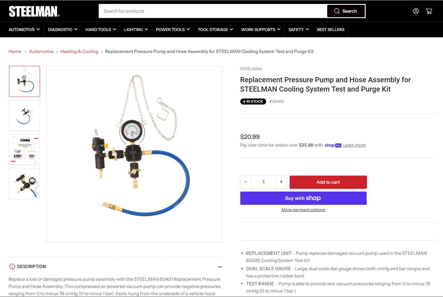

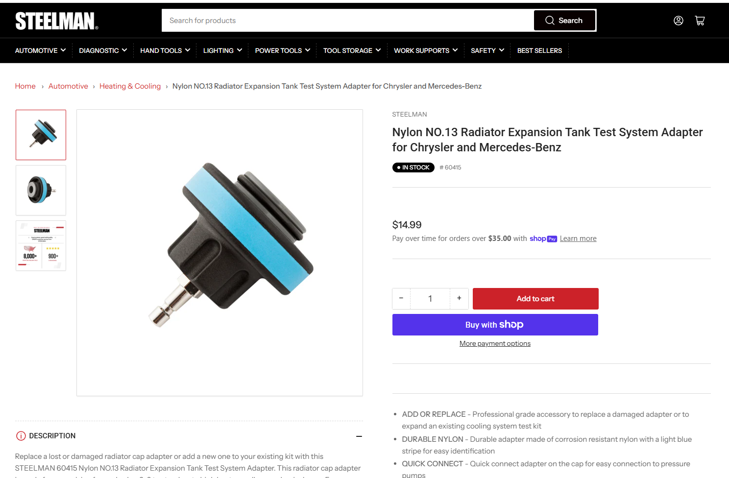

I never worked on that engine before though have seen it is best to vacuum fill the coolant system for intercooler. If you think you have all the air out then great. But an inexpensive solution is use the Steelman vacuum tool. That is if you already have an air compressor. Can get the tool for $21 and the cap for $15 with free shipping on the Steelman website. Its less expensive than buying the large kits that have a bunch of caps you probably wont ever use. Only thing I had to do to the tool is swap out the fitting at the bottom for the coolant fill hose with just a regular nipple. That cap fits the regular coolant reservoirs, not sure if the intercooler cap is different?
https://steelmantools.com/collections/heating-cooling
