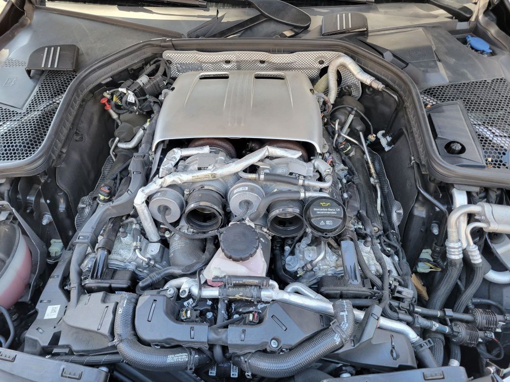

1) Here's how the car looks with no intakes.

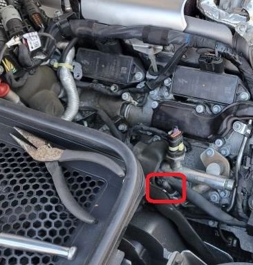

2) Step 3 of the installation involves re-routing part of your electrical harness underneath a hardline on your passenger side. This was a mild pain in the ***. My best guess from analyzing the photos vs my engine bay is that there is a slight change in PFL vs FL cars with a sensor location. The sensor bung, highlighted in red in the image below, made this a very tight fit.

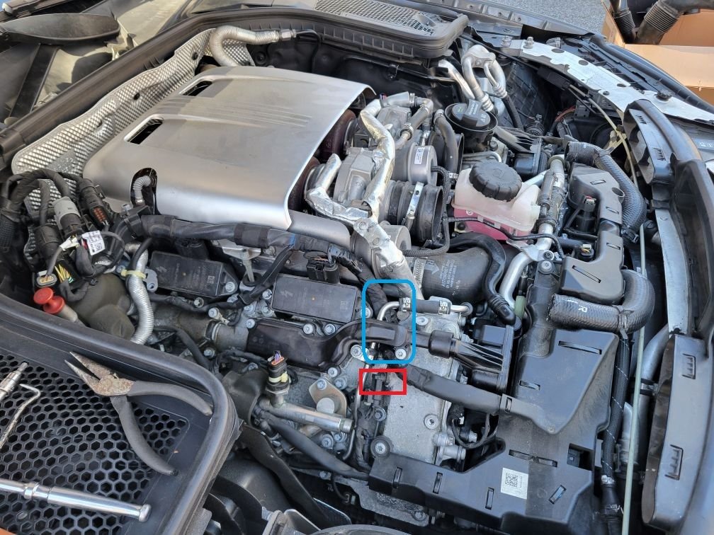

3) PCV unit is glued into the intake couplers. This is covered in other posts, but the important part that I didn't catch elsewhere is that it's glued mostly around the bottom of the connection. I worked at this with a small hose pick and was able to get it free. Drivers side was much worse than passenger in glue qty.
4) I did not take pictures of this part because I was too busy trying to figure it out. The stock intakes mount on ball studs. Weistec replaces those with rubber mounts that have threaded studs on both sides. One side threads into the engine block, other side is used in your intake, and a castle nut threads on top to hold the intake housing in place. Drivers side was fine. Passengers side was not fine. In the image below, I highlighted the area I'm talking about. Basically, the rubber mount that replaces that stud tends to sit at an angle. The aperture on the intake which is meant to accommodate that rubber mount stud does not give good access to allow the castle nut to thread onto the stud. I spent a good hour+ on this before my wife took pity on me and gave me a hand. It took an immense amount of manipulation to try and get the stud to poke through the aperture to where I could thread on the nut. Even so, I eventually replaced the castle nut with an otherwise identical flangeless nut to make this happen. 0/10, did not enjoy this part.
5) Last surprise is that the original recirc lines do not have a connection point on the intakes. I did not find this anywhere in the instructions or description of the product. Not a big deal, but consider it an FYI. Here's a picture of the finished product. Excuse the dirty bay, I was all out of ****s to give at that point.

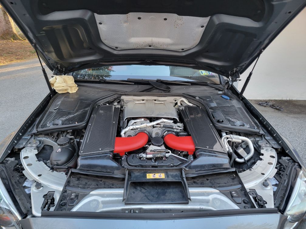

I also didn't mention how hard I had to fight to get the passenger turbo coupler on. Par for the course with a tight bay, but RIP my knuckles. Anyway, finished product looks decent. Impressions: Not much change from a sonic perspective except the disconnected recirc lines do provide the occasional BOV-like noise. Certainly not enough HP difference for my butt-dyno to detect. We'll see what an actual dyno shows. Hopefully my speed shop has a readout from a stock C63S so I can get a baseline to compare against. I should have thought to get my own baseline, but did not.

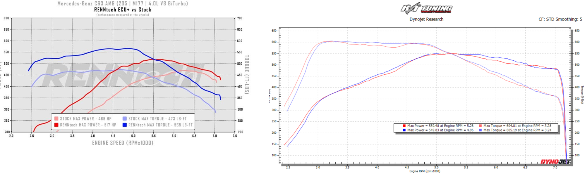

Dyno'd this morning. Sheet attached.

According to this, this is no where near what power gain Renntech claimed on their website.

You do know the difference between HP and WHP, correct? This is actually almost identical to what Renntech advertises, and a big jump over the stock hp on these cars. Sorry you had a bad experience, I don't question that at all, but my results are exactly as advertised.
If you're not aware, a Dynometer measures performance at the wheels - that is, after deducting all 'parasitic' losses from your drivetrain. Add 15 - 20% to this number, and you'll have 'crank' horsepower, which is what Renntech advertises on their website.

This is the Renntech dyno vs my dyno. Youll note that Renntech actually promises lower results than mine.
This is the Renntech dyno vs my dyno. You'll note that Renntech actually promises lower results than mine.
I'm not sure how much of this is due to dyno differences (I can't tell what kind of dyno Renntech was running on), how much is SAE vs STD (Renntech does not note their methodology), and how much was due to the intakes. These charts are supplied as data points only. I'm also running 94 octane (Sunoco)

Thank you for your educational lesson young man. This is not my first car, nor my first attempt at modding. I've been in this game longer than you been alive most likely.
Perhaps your graph was not clearly labelled then. Are the blue and red lines both modded runs? I was assuming one was before and one was after, in which case your gain is only 0.2% and not 15%... But if they are both after the tune then I guess we really don't have a baseline.

As noted in my very first post, my plan was to dyno after the mods. I'm not clear why you would think this car would dyno at 600wtq/550whp before mods. Had I seen a .2% increase, I would have been at least slightly displeased.
You are correct, I do not have a baseline for this car, although I've dynoed multiple cars in the past on this same dyno, both before and after. It reads reasonably close to other Dynojets... not at a heartbreaker level for sure, but not unreasonably high. The shop is called RT Tuning and its fairly well known in PA.

It takes literally a minute to swap between stock tune and renntech tune with the flip of a switch on the module, so I'm sorry, I just assumed that's what you did, when I saw 2 lines each each on the chart. Would've been nice to compare though.
