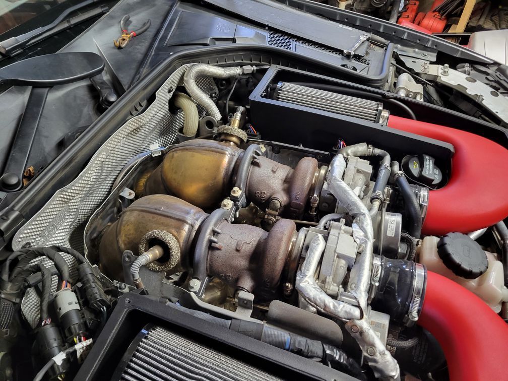

Today's project was a set of ZAC Motorsports turbo blankets.
https://www.zacmotorsport.com/produc...6kikC1w-0boBYo
I picked these up last summer but was busy, put them in a drawer and promptly forgot I had them. If you're not familiar with turbo blankets, the basic idea is first to reduce radiant heat in the engine bay and second to keep the hot side of the turbo hot, improving spool and reducing turbo lag just a touch. ZAC's set appears to be well made and similar to the DEI Onyx Blanket that I ran on my 370z.
Anyway, on to the install. ZAC does not provide instructions, deeming this to be a simple task, and it pretty much is.
0) This task is most easily accomplished with intakes out of the bay. I'm not sure if this is possible with stock intakes, but I took the covers off the Weistec setup and was able to get at everything I needed.
1) Remove engine cover. No pictures of this. This is just 4 bolts positioned on mobile plastic mounts with threaded rods. Only trick here is that you need to grip the threaded rod - this was easily done with either a 10mm or 12mm wrench, I do not recall which.

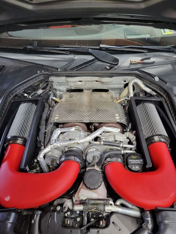

2) Remove heat shield above turbos. 3 bolts per side, socket cap, and one in the back of the bay. I used a ratcheting wrench on these.
3) As pictured above, that will expose your turbos. Now comes the fun part, getting the ****ing blankets on.
4) This part is kind of a pain in the ***. The drivers side turbo blanket doesn't fit very well in the right hand portion of the bay, and ZAC includes these springs to hold the blanket in place. I had to spend a lot of time working on this to get the springs into the right area and clipped on. But whatever, I was able to make it work. Took a long magnet and my largest set of needle nose pliers and a lot of patience as I dropped the spring clips repeatedly into the engine bay. I said many bad words at this point.
5) Re-assemble everything and enjoy. Will report back if I see a difference in either spool time or if temps change in any unexpected ways.

okay Josh - we only make a discussion here - everyone can do what he wants on end. I am always happy and grateful when I meet genuine experts in forums because we all know not everyone can know all.
1. Can you show a picture in closed condition please ?
Sure.
2. i know down pipes ( with catalysator) and the good (expeensive) of them are all isolated. i would guess there is a reason why.
Yup.
3. turbo blankets info (have you a link to your posting ?)
^ there is an immense amount of information available to you through a simple google search, which I will do for you, and curate this down to a single video. Please enjoy.

@JoshLarson Nice job on the write up. The only thing I would correct you on is in step 1 you don't have to remove the nuts from the "threaded rod" to remove the outer heat shield / engine cover. Those "threaded rods" are just pushed into rubber grommets. They all have a little ball on the end and you can just pull up on the cover and they pull out of the rubber grommets. There is no need to hold the bottom of the little post and unscrew the nut.
Second, when I put on the Zac Turbo Blankets I found it very helpful to put the springs on one side of the blanket and then use some needle nose pliers to close that end of the spring hook a little so it wouldn't fall off the turbo blanket when you put it on and tuck it under / around the turobo, then all I had to do was grab the other end of the spring and pull it over to hook on the other side. I also found Zac's springs to be a little long so I trimmed one and reformed a hook end.
Overall I am not sure I notice quicker turbo spoiling, but I do think it keeps underhood temps lower. I used to drive my car to an event and pop the hood and the heat wafted out. Now it's more like a normal engine, and it doesn't seem to have as much radiating heat from the turbos. My Modal Works downpipes are also completely heat shielded, including the cats, so that's probably helping too.
Lastly, I have a Zac Motorsport intake system too and I think it works better than stock. I can definitely tell that the car doesn't run out of steam on the top end anymore. My intake temps are the same as stock, and often a little lower at cruising speed.

Oh ****, neat! I totally missed that - thanks for the tip! I'm still early into my Merc learning curve, so this is very helpful.
Regarding the springs, pretty sure they fixed the length... I did something similar to what you described, kind of squished the hook down to better retain the springs. Passenger side went ok, albeit very slowly. Drivers side was very tight for one of the springs and I had to get creative with fishing it + pulling on it.
