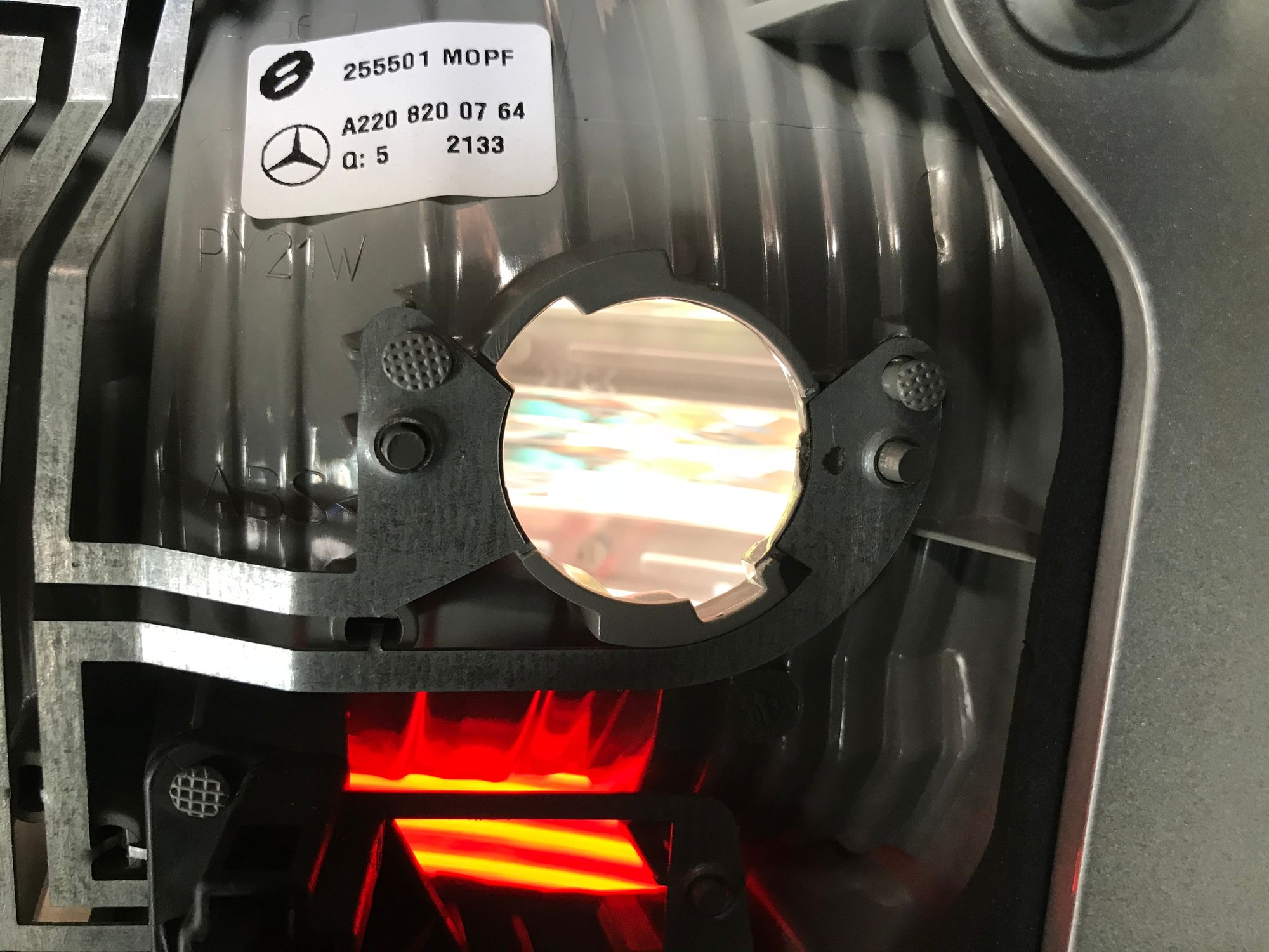

I just went thru this.
Zoom in on the black spot next to the buib hole.
I bought a new bulb and socket at the dealer. Still had the problem. Then went into the inside of the tail light. Found a dark spot on the metal, buffed with the wire wheel on the dremel grinder, added a coating of dialectic grease. Put everything back together. No warning message for the last month.
