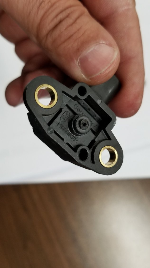

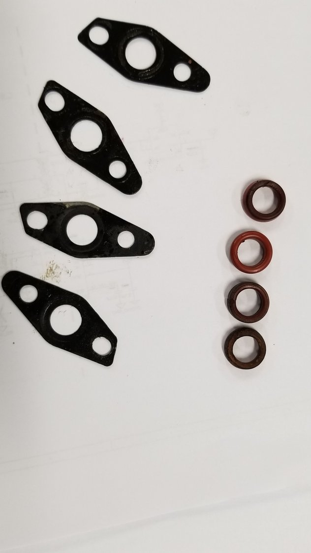

The car has developed a misfire again, and so I had Clark rebuild my voltage transformer just in case but that wasn't it. Since I had new coil packs I was getting a bit edgy, but decided that it was time to change the valve cover gaskets since I had seen the oil leaking into the plug wells . When the coil packs were removed, noticed the turbo water line seals were leaking. The o rings were in pretty bad shape . But also, one of the MAP sensors on the intercooler line had physically broken .Misfire solved .

Pics

You need to order 28 bolts when changing the valve cover gaskets BTW
