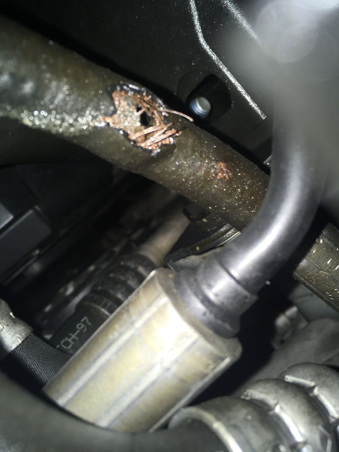

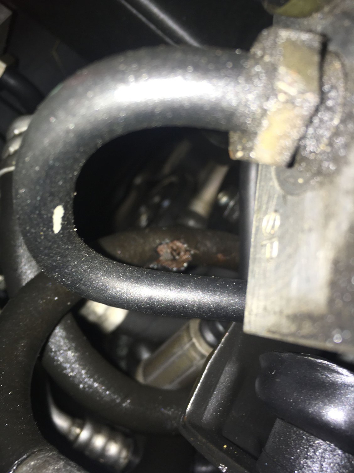

Got the car up, found the culprit line. Pics attached. It’s the hose on the passenger side of the front left valve block. Haven’t figured out where it goes. Seems like an unusual way to fail. The hose itself also seems rock hard.
I’m going to have a hydraulic shop replace the rubber hose. I’m now debating replacing some more rubber hoses while the system is out. Thoughts and prayers for the ABC pump.

Hellll no. ABC is awesome. I’m going to have some hydraulic shop plug the hose, refill the system, and enjoy the best suspension system in production today.

Fixed. Total cost: $65. $35 for the hose repair, $30 for ABC fluid (about 2.5L).
When reflilling, the pump needed priming with an air compressor, just something to think about.
