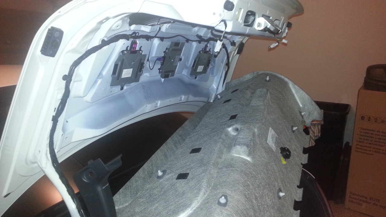

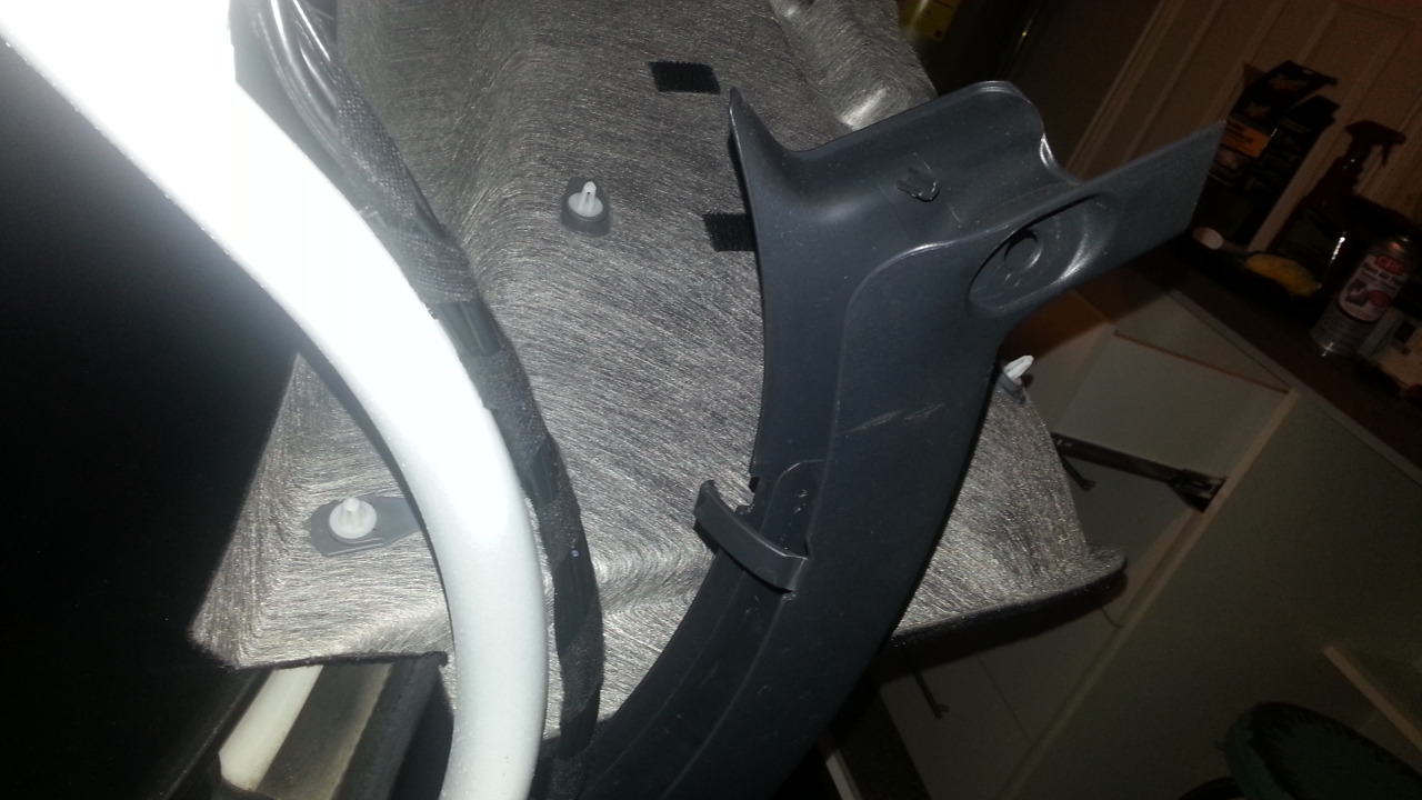

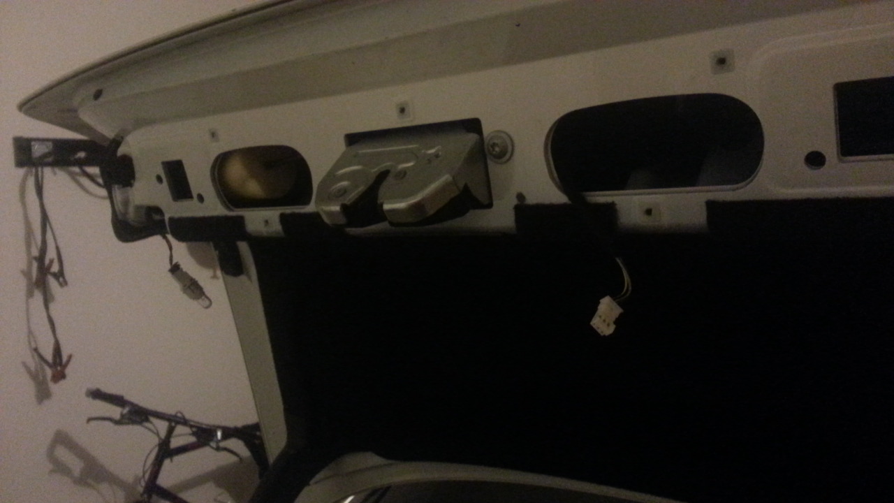

I recently did this. First, you have to remove the leading edge plastic trim (screws) and then the felt trunk lid liner (snap on clips). You can then reach in and remove the panel that houses the license plate lamps and trunk handle. Once removed, you can access the license plate lamps which can be popped out and replaced. It takes about 20 minutes. I bought a set from eBay for $30 no error codes. http://cgi.ebay.com/ebaymotors/ws/eB...K%3AMEWNX%3AIT

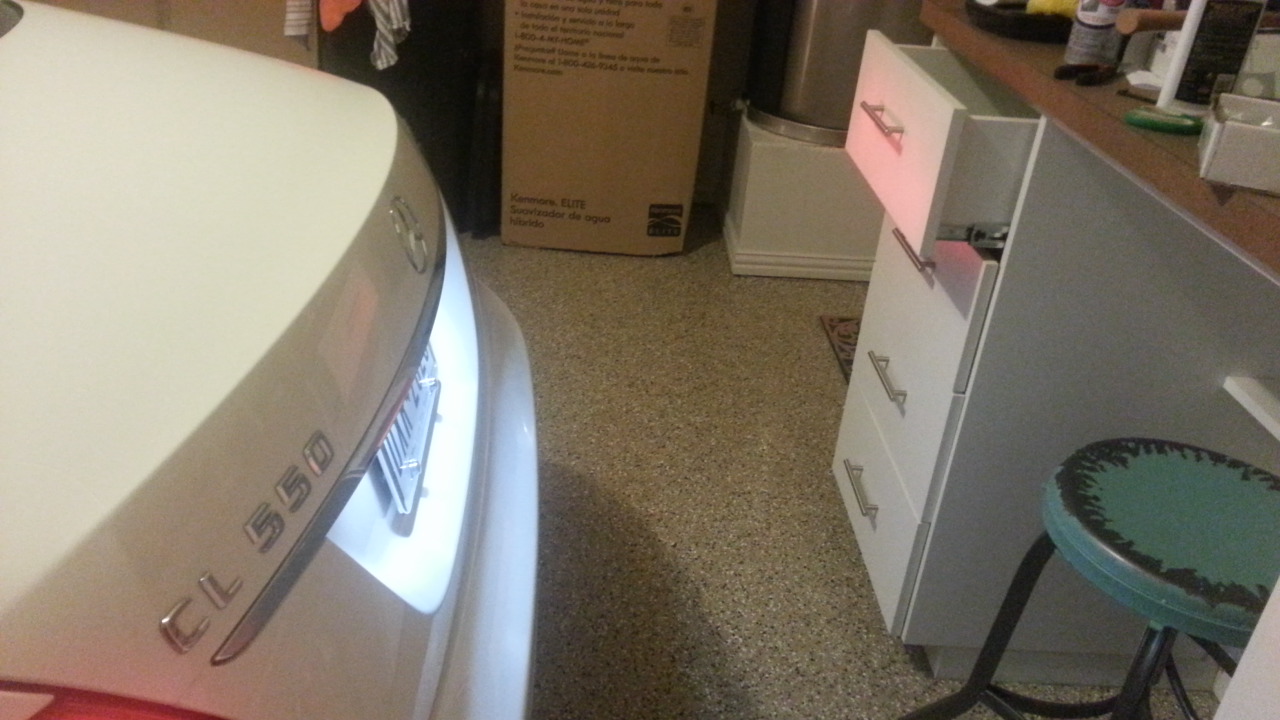

Talking Love Em'
Originally Posted by AZN Optics
You'll need 194 wedge LEDs. They have to be canbus units to not trigger codes. We have these available in pure white 5000K for $19/set. Plug and play

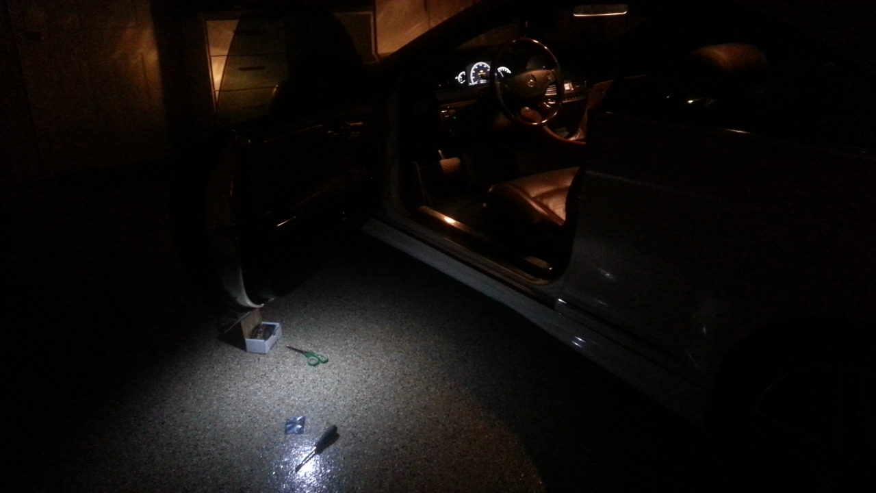

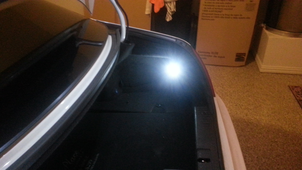

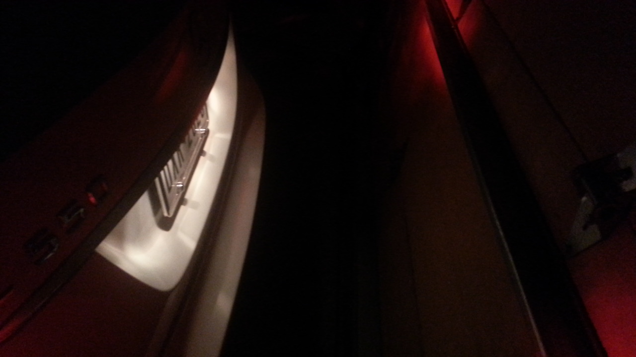

I did my floods, trunk, license plate lights the other night... Came out great! Thanks
Still waiting on messing with the little mirror flood lights, fogs, and headlights...
