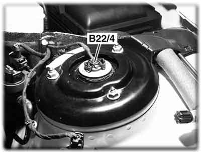

Originally Posted by cl600bill
[B]Incidentally, I have had a low speed minor "clunking" that seemed to be coming from the left-front that nobody could diagnose.
the big square nut under the sensor connector on the top of the shock had backed off. they do they do that and when they do- the shock clunks - especially when cold... i am surprised they are not loctite-ed from the factory or something.
What part do you mean? the center part under the sensor between the three bolts?
Remove the sensor plug (it pulls right out). Remove the white plastic washer. Underneath it there is a large square nut. At least that how it is on mine.

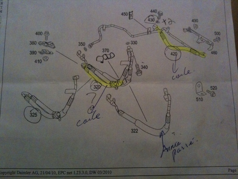

I think there is a hose with a dead end, that is the hose with the internal damper.
Old Aug 20, 2012 | 02:50 PM
  #42
slonar21's Avatar
Joined: Feb 2005
Posts: 254
Likes: 17
From: America
CL600 2003
I think it's # 325 in the diagram
Attached Thumbnails ABC ACTIVE BODY CONTROL DRIVE CAREFULLY??-313564d1276458916-abc-issues-more-photo.jpg
Slonar21, yes that is the hose I was talking about. Since it self destructed I was able to take a pretty close look at it and I found there was nothing significant about the hose. It was simply a banjo fitting at one end which fed into a flexible inner nylon lined section which then fed into a stainless 180 deg bend which fed into another flexible inner nylon lined section ending in a stainless metal cap. I just can't see how the construction of this hose would lend itself to perform any function what-so-ever. There are no "rebound" damping properties to this hose. During normal operation it would have been completely filled with hydraulic fluid which would sit at the full pressure of the system at all times with no circulation of the fluid at all. Anybody truly "KNOW" what purpose this hose serves?
Thanks,
Brian

Well I found the replacement hose for $242 delivered part number 2203205372. Can anybody beat that price? By the way, I asked the dealer what the purpose of the hose was and they have no idea. He only told me that they fail so often it has driven his inventory to carry 2 on hand at all times.
Old Aug 20, 2012 | 06:23 PM
  #45
alx's Avatar
alx
Joined: Dec 2004
Posts: 4,268
Likes: 253

Here is what the part looks like when complete and new
Wow. This definitely looks like a damper. Notice the spiral imprint in the hose- it prolly expands under the great pressure of the abc. A man learns something every day
You did not read my previous post- did you
ALX, yes I did read your previous post. The price, $242, is the $208.80 you mentioned plus the $31.32 Shipping plus the $2.00 Handling fee. I was just wondering if anybody knew of anything cheaper.
Also I disagree the hose is some sort of damper. The black rubber sheath is just there for protection. Inside it is a very rigid, non expandable inner nylon hose that is rigidly attached to all of the metal pieces. Trust me, there is absolutely no expansion of the hose. There wouldn't even be any air trapped in the hose since the fluid is pushed down from above which would allow the air to eventually escape.
Take care,
Brian
Ah, i see. Did not add up the numbers. Parts.com is usually the cheapest source for oem parts that I know of.
Regarding expansion- At 180 bars anything non- metal expands. I am also sure that during operation there are much higher pressure hits. It has to be a damper. Otherwise as you noted this part makes no sense.
I have to concur with 04S600AMG on this one. There might be some expansion on the hose, but it certainly is not acting as a "damper" IMHO.
