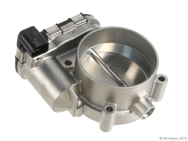

"01 25" is like any normal MB throttles & used in "N/A M113's/M112K/M272",,

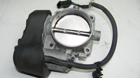

while "06 25" specifically for "M113K" only, and comes with cable & rubber cap..!
-;ZAYED;-

is 06 25 not just 01 25 with the cable and rubber buffer?

As i know; "01 25" uses a differ pin wiring diagram & differ functionally coded through ECU than "06 25"..!
-;ZAYED;-
