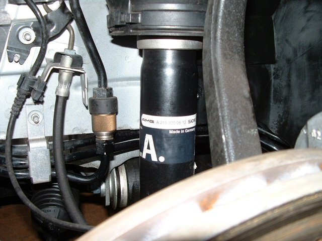

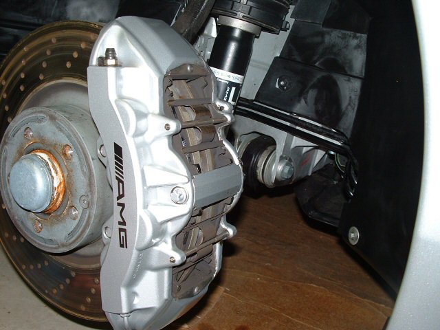

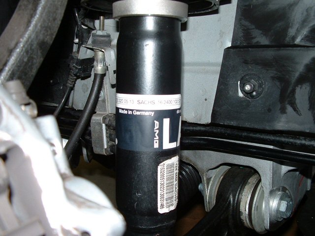

Pick up the AMG brochure at your dealer (I have the 2003 edition). They are hard to find but most dealerships may have some. The AMG specific brochure only has the AMG models in it with a lot of great pictures and information.
If the suspensions are the same AMG/MBUSA have some big fat lies in that brochure.
They even go as far as saying not only is the ABC programmed with AMG specific programs but also ESP, etc. has specific AMG programming.
Some quotes say,
"Additional features of the 2003 CL55 AMG include Active Body Control with firmer suspension profiles"
"AMG-enhanced dual-circuit power-assisted 4-wheel disc brakes"
"AMG - recalibrated ESP"
"Active Body Control (ABC), a true active suspension system recalibrated by AMG, utilizes a coil spring and an absorbers. Rear: Rigid axle with longitudinal and transverse links, coil springs and electronically controlled hydraulic cylinder in series, plus a separate AMG gas-pressurized shock absorber at gas-pressurized shock absorbers."
It would also mean the AMG logo/part #'s on my front shocks (in the form of stickers) are a lie too. See pics at bottom.
Bottom line is someone doesn't know what they are talking about in MBUSA.
**** I found the 2004 AMG digital brocure on the interent. You can download it here: http://mbusa.designory.com/my04_amg/..._ebrochure.pdf

Ok, I have the different part #'s now for AMG and NON AMG CL suspensions. I will post later tonight when I get home and can fire up my EPC (Electronic Parts Catalog).
Old Jun 24, 2004 | 06:27 PM
awiner's Avatar
Joined: Nov 2001
Posts: 6,340
Likes: 22
From: Southern California, USA
2003 CL55 AMG
According to what I have been able to get out of this program so far, AMG models come with a "AMG Nurburgring Sports Suspension". In Germany, CL500 and CL600(With M275 Engine) vehicles can actually have this same suspension fitted at the AMG factory in Affalterbach.
The EPC shows this option (A 215 320 00 30) as standard on the AMG CL55 and as a AMG Factory fitted option on the CL500 and CL600 (With M275 Engine).
The description says, "Spring Struts at FA/RA, ABC suspension"
I am getting the front end to the EPC soon so I will be able to see a exploded diagram of all the parts and indivudual part #'s that are assigned to each.
