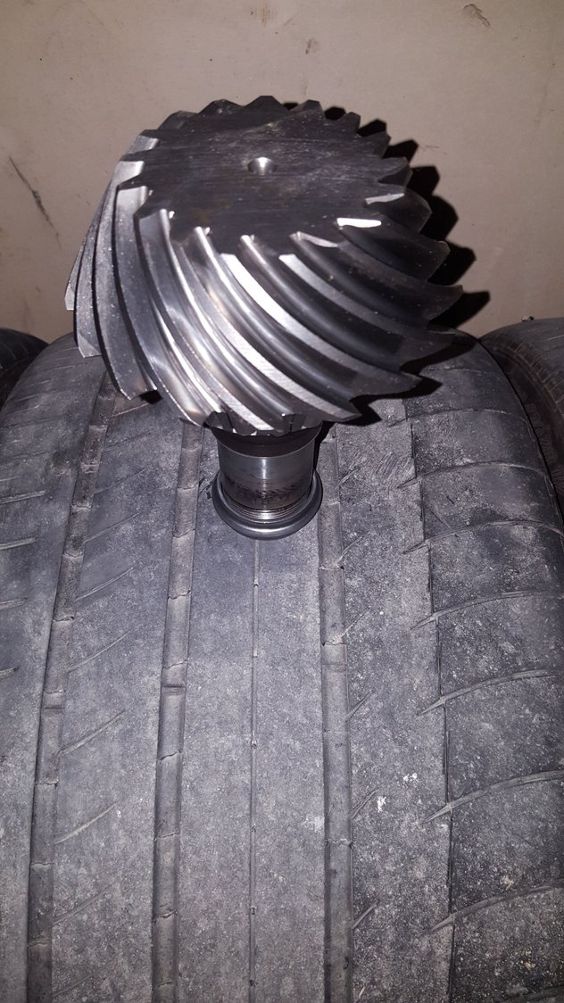

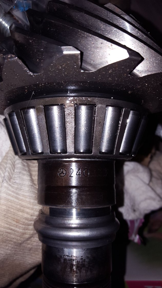

I don't have any specs, but I can show you what it looks like snapped. I'll count the teeth when I get home. It has a Maybach 240 chassis part number, but supposedly the 2.65 ratios in our cars weren't offered on the Maybach, only the 2.82 were at the time. It looks like a totally different housing between the two cars. Im sure the new ones are different as well. Also, I don't think MB offers the ring and pinion separately, only in a complete rear diff. What are you looking to do? You'll find there are a lot of weak points with sticky tires if that's the direction you go.

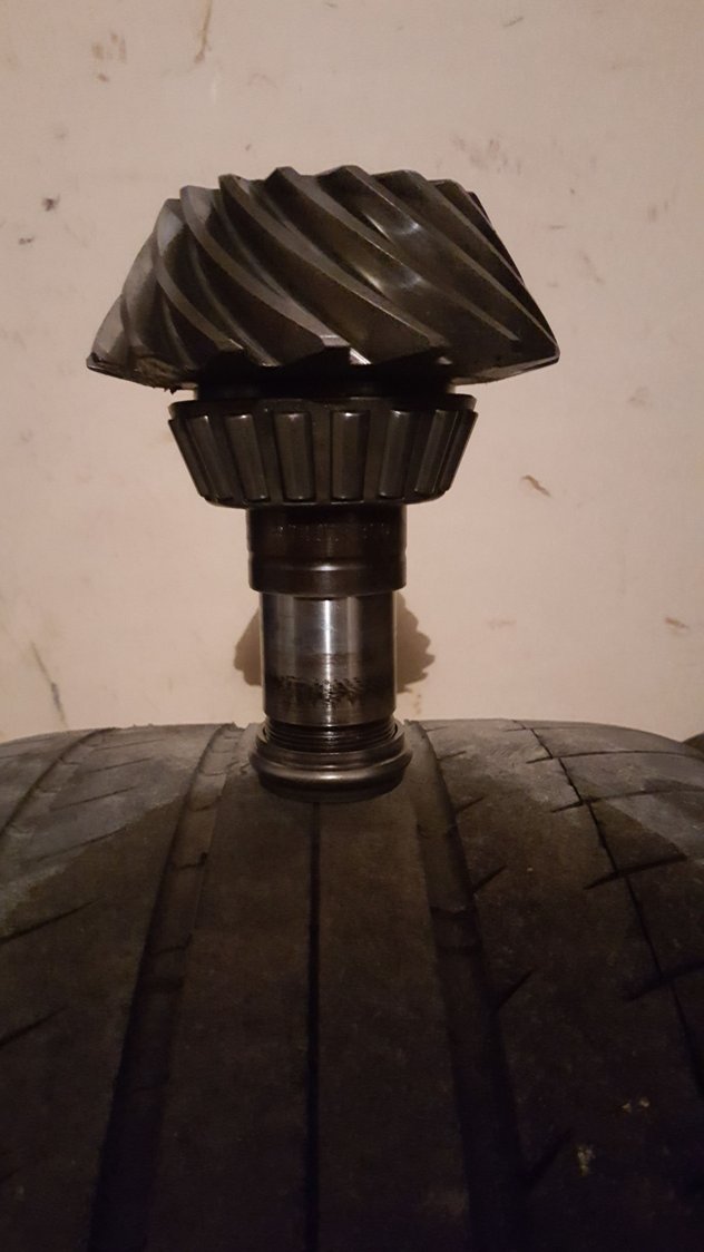

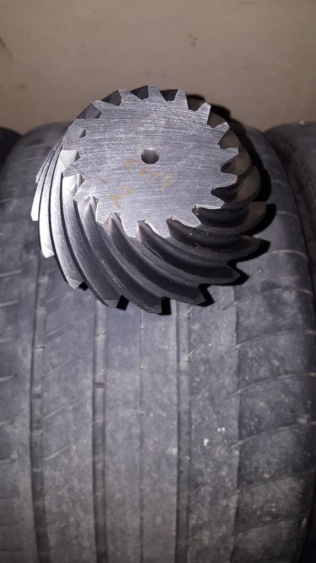

A few extra pics to count teeth. That's a 305 tire underneath, gives you an idea of how wide the pinion is. You can see how it tapers in the first pic making the shaft skinnier. Not sure if that is to exit the housing or just for the bearing, but either way it becomes the place to break.
