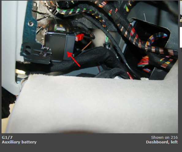

I removed the tire cover and back seat cover inside the trunk and found out that my auxiliary battery is NOT inside the trunk. It must be on the drivers side under the foot panel.

Does any one know if will my memory be saved if I remove disconnect the negative terminal form the Starter Battery (Engine Bay) first, then remove the auxiliary battery (Part # A00000 0004039) from under the drivers side dash board ? I just want to do this right the first time. Thanks for all your help with my "auxiliary battery malfunction" problems.

I purchased a new auxiliary battery from the dealership (A0000000004029) and replaced it. My W216 auxiliary battery was located under the driver's side dashboard (outside panel). It took me 30 minutes and as is well. I had to disconnect the NEG terminal from the starter battery before I replaced the auxiliary battery..
