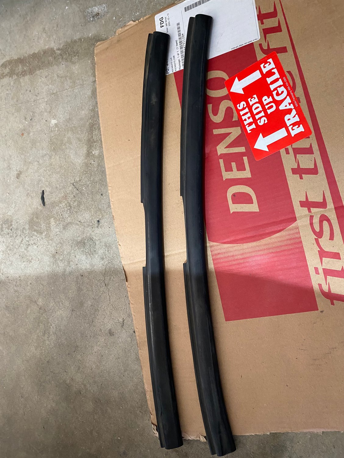

So I am completing a radiator replacement installation, and I cannot for the life of me figure where these two seals went. Googling part numbers wasn’t helpful, neither was the WIS. I even called the local stealership and while they tried, it showed that it attached to the secondary cooler but I don’t see how that’s possible as this part has a curve to it, and the cooler is obviously straight. Part# A221 505 02 86. 2008 CL65
Thanks for the help!

Those are not flexible so that they would straighten out? They seem to be some seal and the dealership description seems to make sense. Good luck.

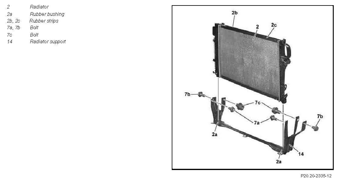

Could it be parts 2b & 2c in this diagram?
