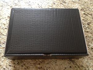

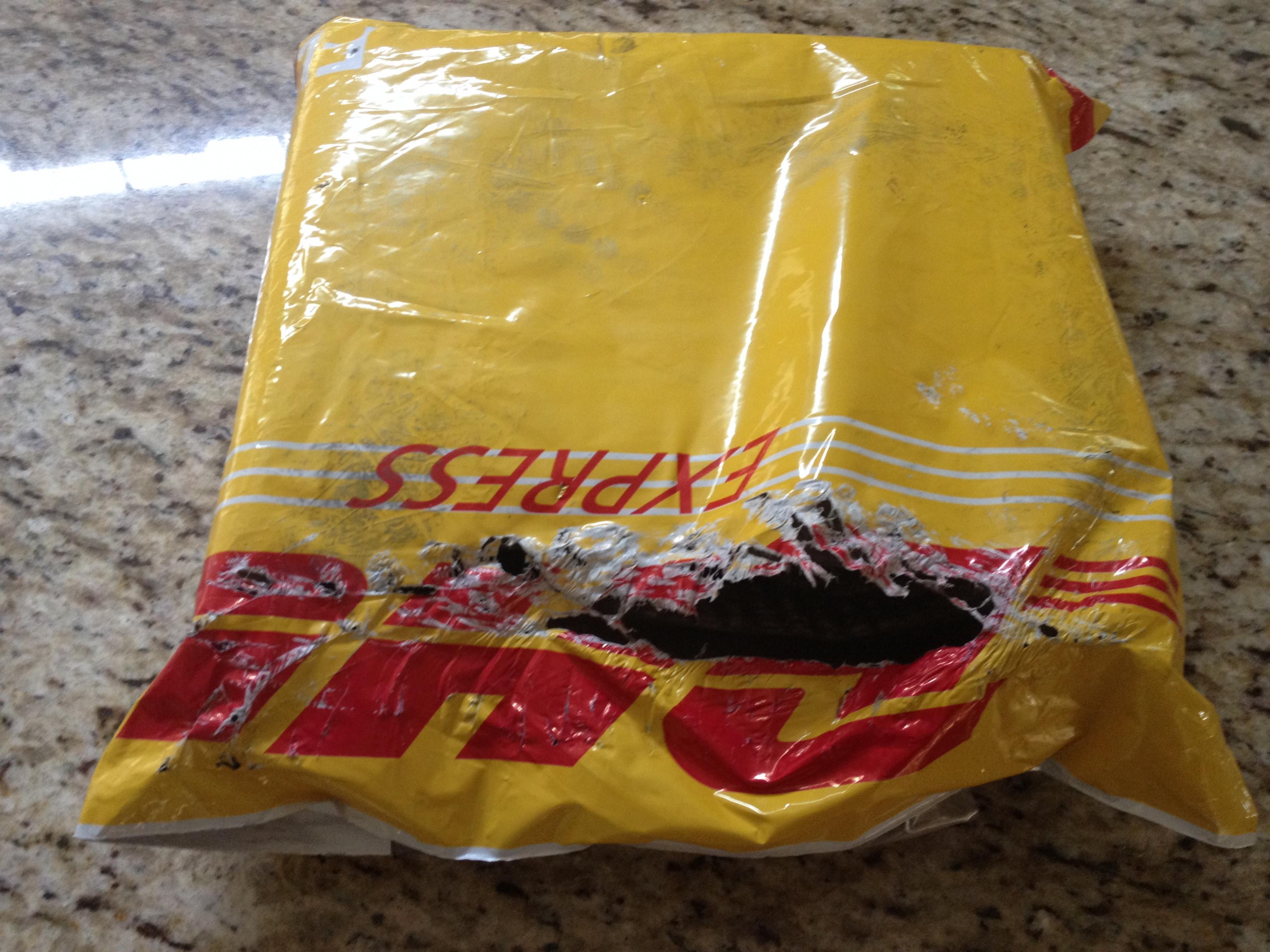

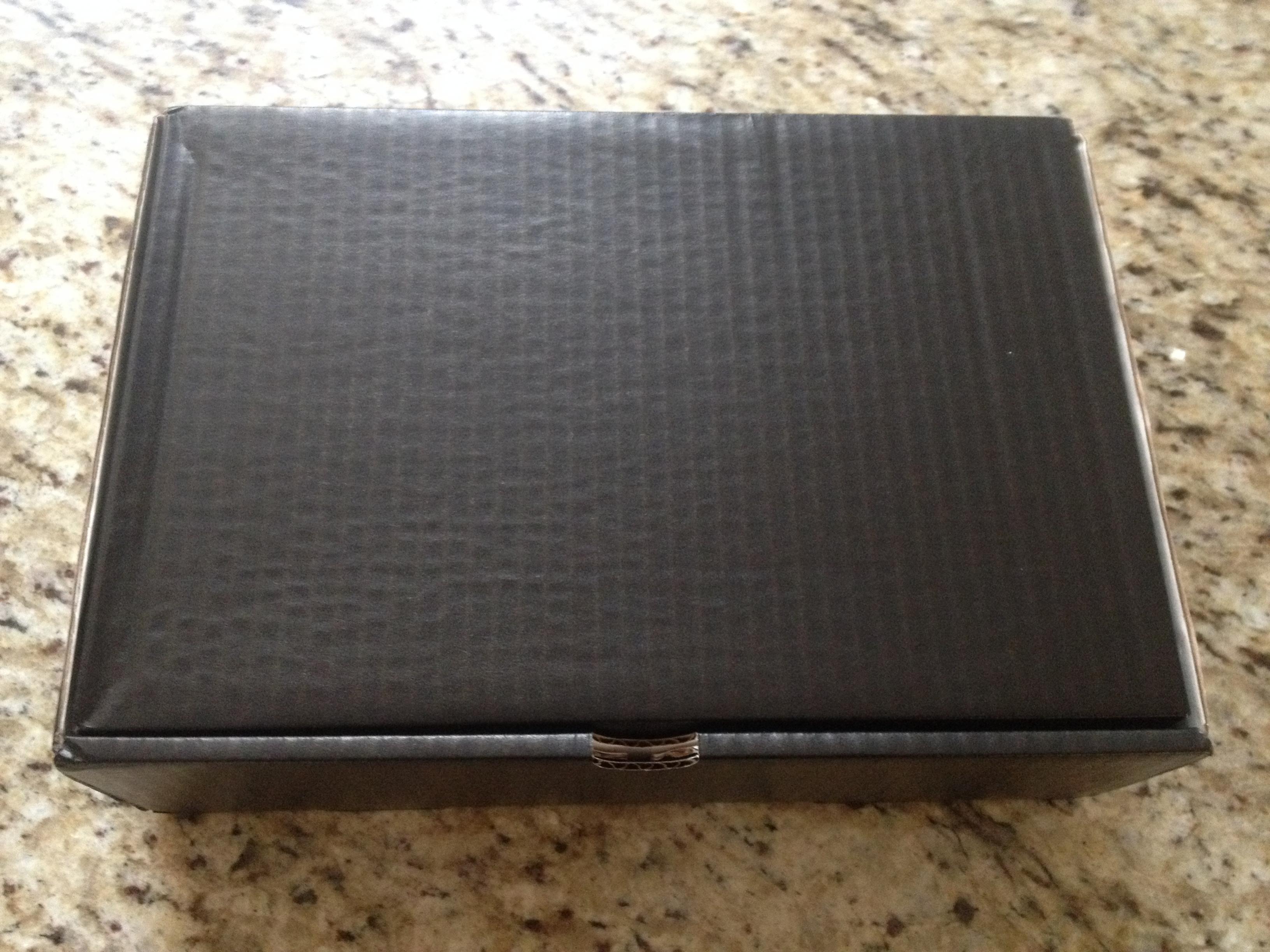

Rebellion stage one arrived!!
Well when I got home yesterday I saw a package on the porch. The first thing I noticed was that the package was torn and I cringed. The box appeared intact and contained a wire harness (plug and play) and a Rebellion "black box" and a couple black plastic zip ties. I was surprised to find no directions in the package. I was not sure if someone tampered with the box or it was an oversight, either way no instruction. This means I have no idea how to install.
I e-mailed Matt at Rebellion, and to his credit he responded quickly and provided a link to instructions. I am pretty good with cars, but I will say I had a hard time with this initially, as you guys know what an AMG engine looks like. I did figure it out and got the system installed. The directions to not say what to do with the actual Rebellion box or how to secure it or to what. I also do not know exactly how to disconnect the system when I bring the car for service. Do I just unplug the Rebellion box and cap it? Or do I disconnect the entire system, which will be a major pain? I have not driven car yet and I will update on the performance. I will say that Rebellion Automotive (Matt) has been great thus far and has always answered me via e-mail.

Rebellion Tune Stage 1 package
CLA45 AMG Tuning Special Offer - Rebellion Automotive-photo-1.jpgClick image for larger version
