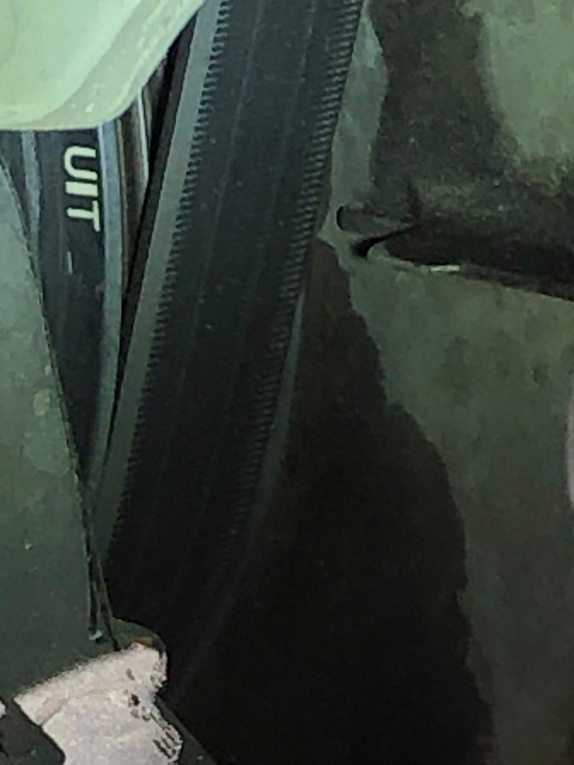

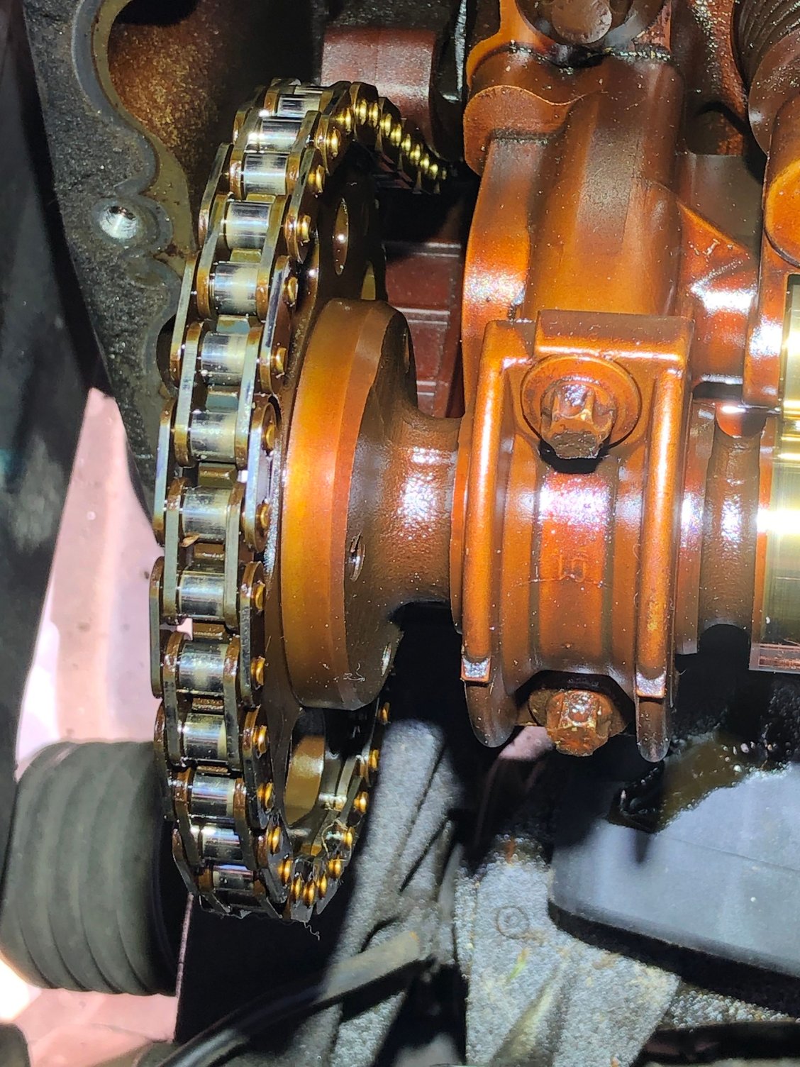

I was working on replacing the timing chain as it was making some noises during cold start. The noises went away after about 10 sec, then it sounded normal.
I took off the intake, the rocker cover, exposing the cam shaft and the chain/ sprocket. I then removed the right side wheel lining to expose the crank pulley which I can turn manually with a 17mm Hex bit.
I turned the crank clockwise until the crank is at TDC, when the O/T mark meet the marking on the crankcase. Please see picture. However, when I turned to the cam, the marking on the cam is way off. Please see picture.
What do you guys think? Am I missing something?
Crank at TDC
Crank at TDC
Mark on cam is way off

My stupid contribution for the day: Is it off by 180 degrees?
From a visual judgement, it is about 30 Deg off.
