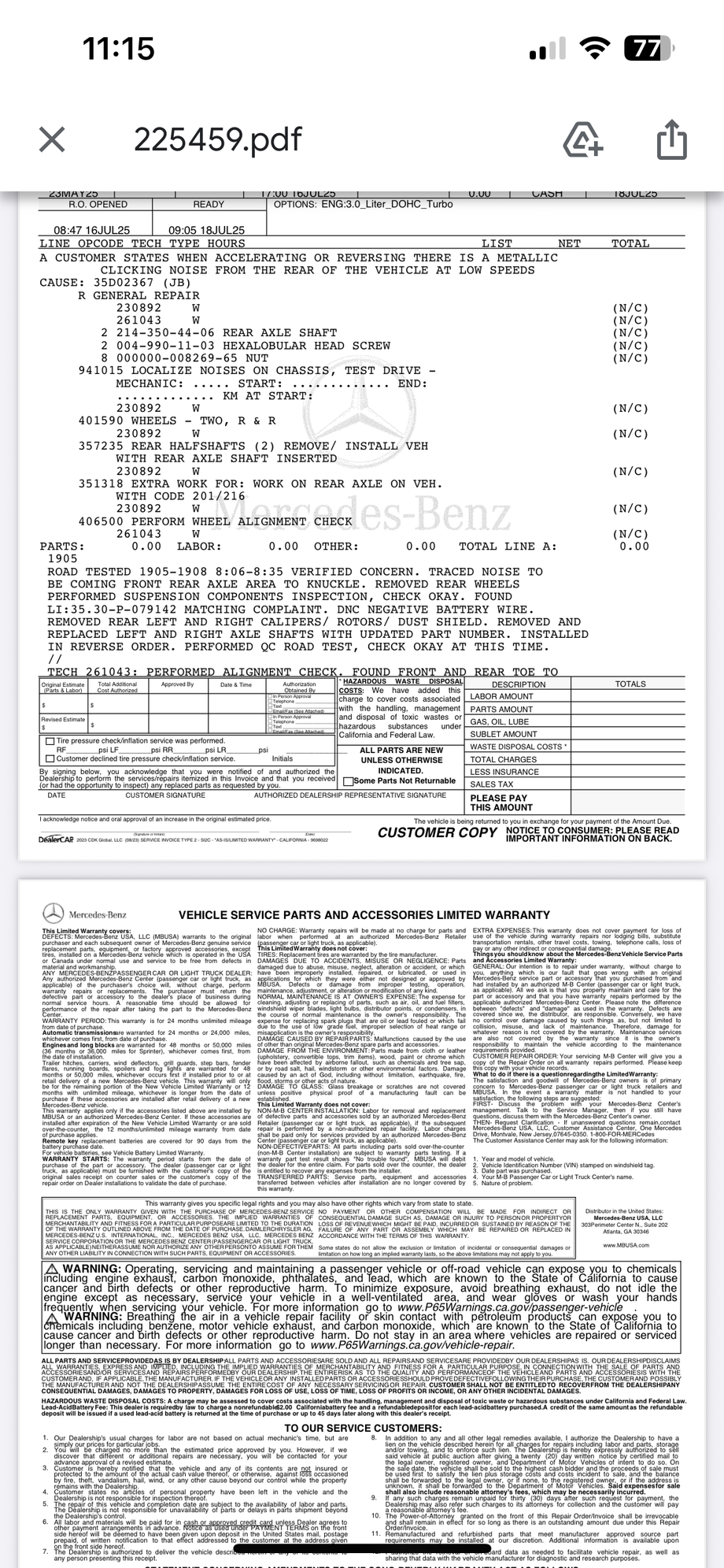

Mine hasn't come back months after repair. So far... lol I posted a while ago with the work sheet.

Old Mar 18, 2025 | 01:33 PM
  #157
JorgeDu75018's Avatar
Joined: Mar 2025
CLE53 Conv
I will go to Mercedes with your documentation to make it easier to them...! Thank you
No probs! If they need to call them for any extra info: it's Mercedes Benz In Encino.

Originally Posted by ryzi
Here's my work sheet after getting my car back. So far no noise! Fingers crossed.
hi - has this fixed worked. Had the clicking sound not come back?
It's worked, haven't heard it since i did it!
