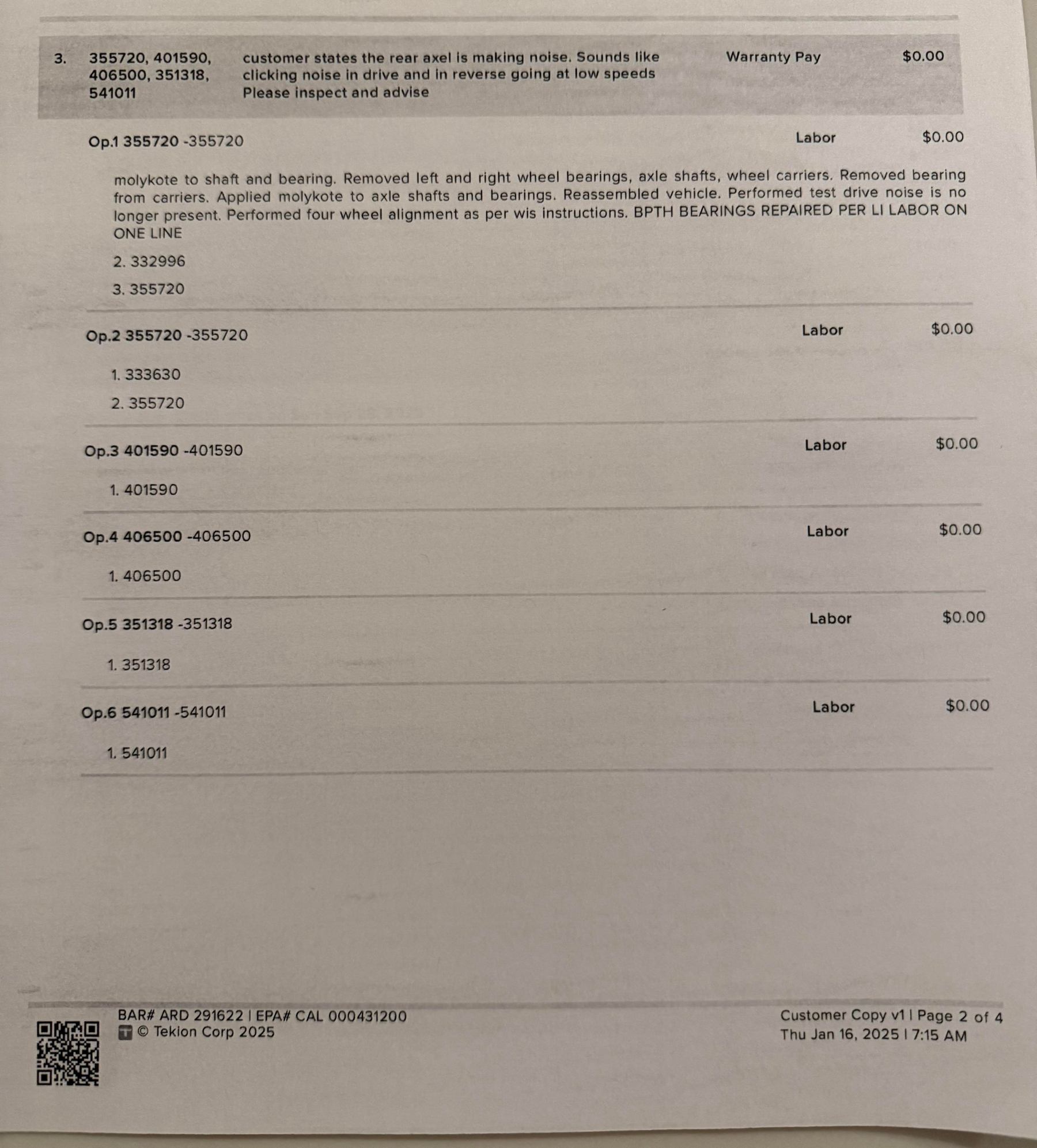

Update!
Just got my car back today here is the repair sheet they provided me with I hope this helps some people. Drove around a good amount today and no more noise so let's hope it stays that way lol.
Thanks for the update man!! I think I'll take mine in on Monday and show them this. Hopefully speed up the process lol.
Looks like a similar fix to mine. Took things apart and added anti friction paste. I hope this is a long term fix.

So as I suspected, bolts not having anything to do with the actual fix as it was just the anti-friction paste which is indeed a bit concerning for the longer term.

I'll post my worksheet when I pick my car up tomorrow but the SA and tech agreed with this forum thread and said the rear axel parts needed a lubrication process applied to it. I'm assuming the anti friction paste everyone has mentioned here. I referenced this thread and all of the work sheets from past repairs on here and she was so open to reading and seeing all of the posts. Highly recommend Encino MB in LA for this quick fix for this issue. Very fast, very receptive to research/notes and quality service. Can't wait to pick up the car in the morning!

Here's my work sheet after getting my car back. So far no noise! Fingers crossed.
