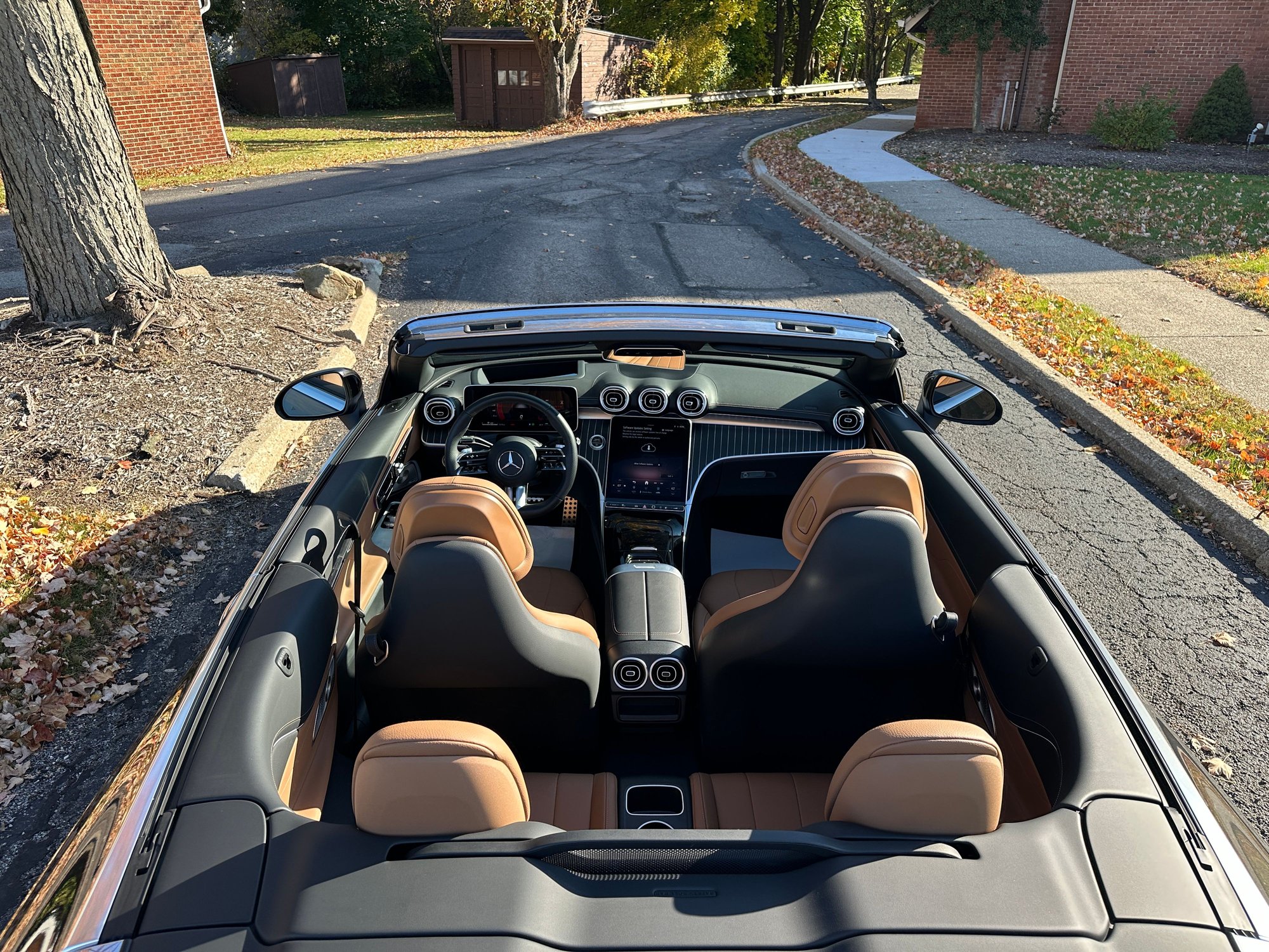

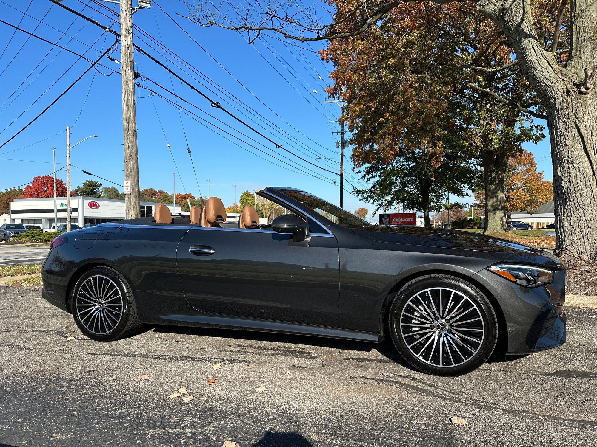

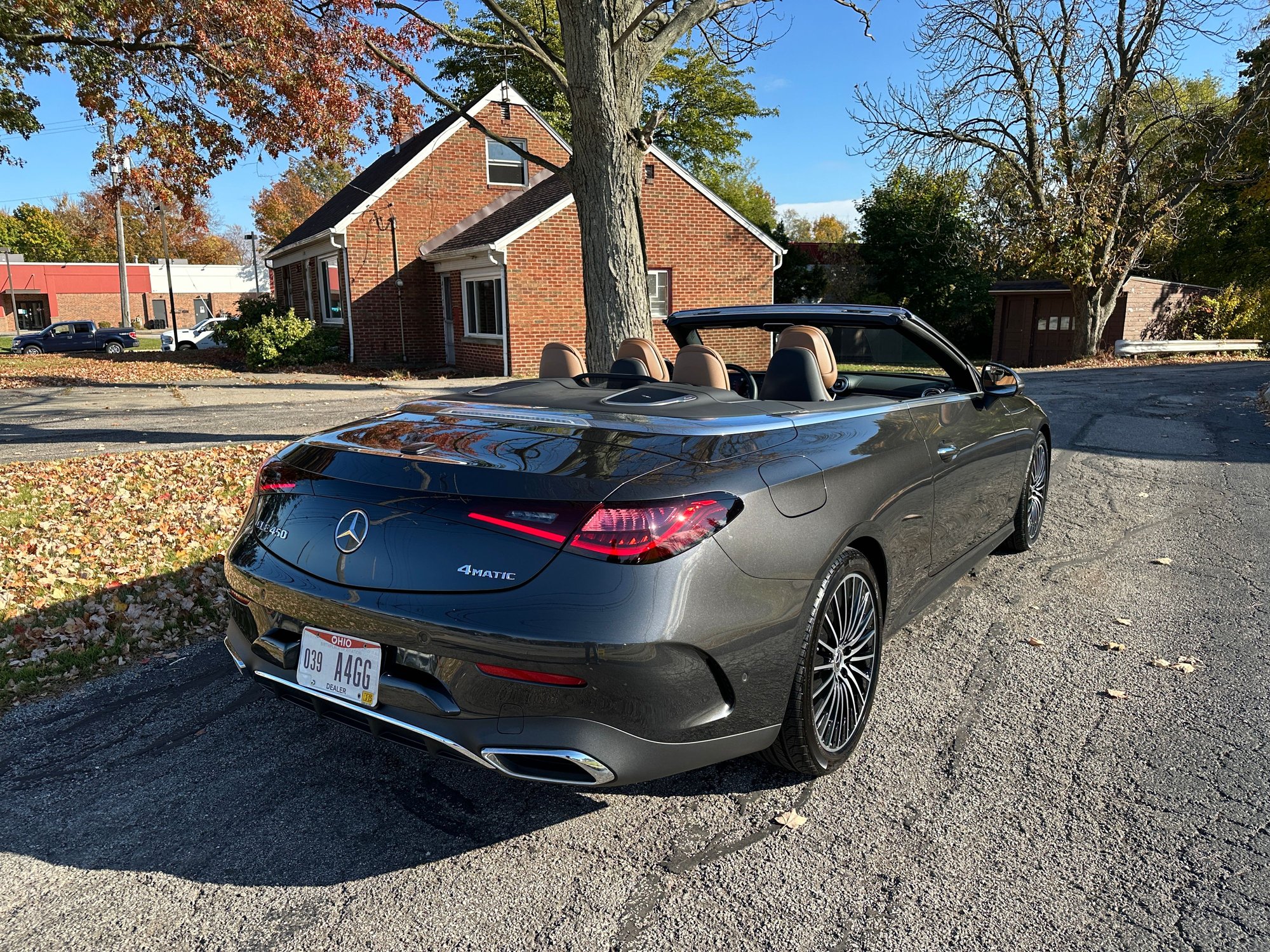

Great looking cab, glad to hear it was a quick fix.
