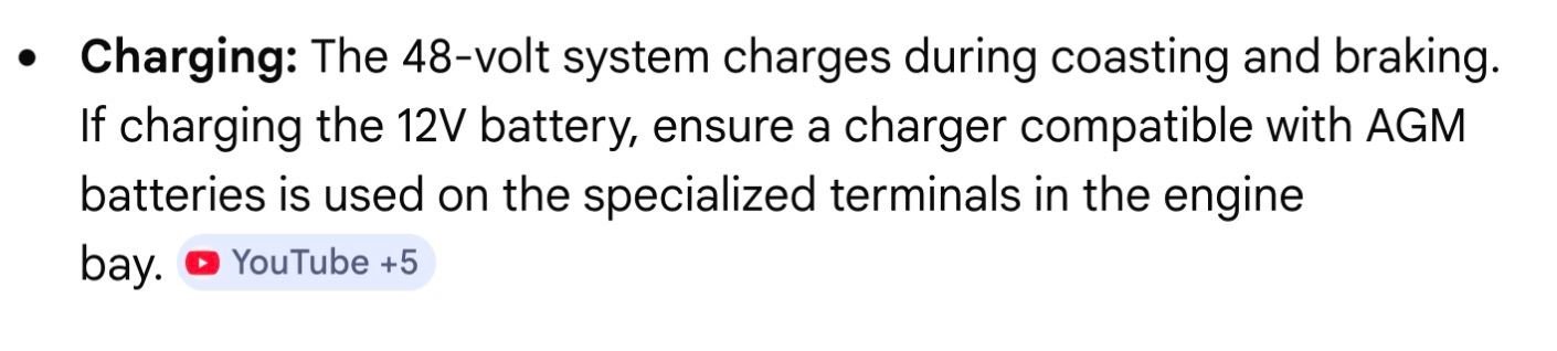

Originally Posted by SdeGat
Thanks @PHXATC, I’ll have to try that.
How about this statement about AGM battery?
Not entirely sure about what that statement means, other than ensuring you don't use a Lithium Ion charger on an AGM battery and vice versa. I have one of each (chargers) and just ensure I have the right one when I put the CTEK charger on the battery. I do not know what the charger would do if it was mismatched with the wrong style battery, however I am not going to try it.
Is that part of the AI summary? AI can make mistakes and make things confusing after all. Perhaps go directly to the source for the complete picture.
I wonder if modern trickle chargers have some sort of protection feature to automatically stop charging if it detects it as the wrong battery type. Yes, don't use your own car as an experiment.

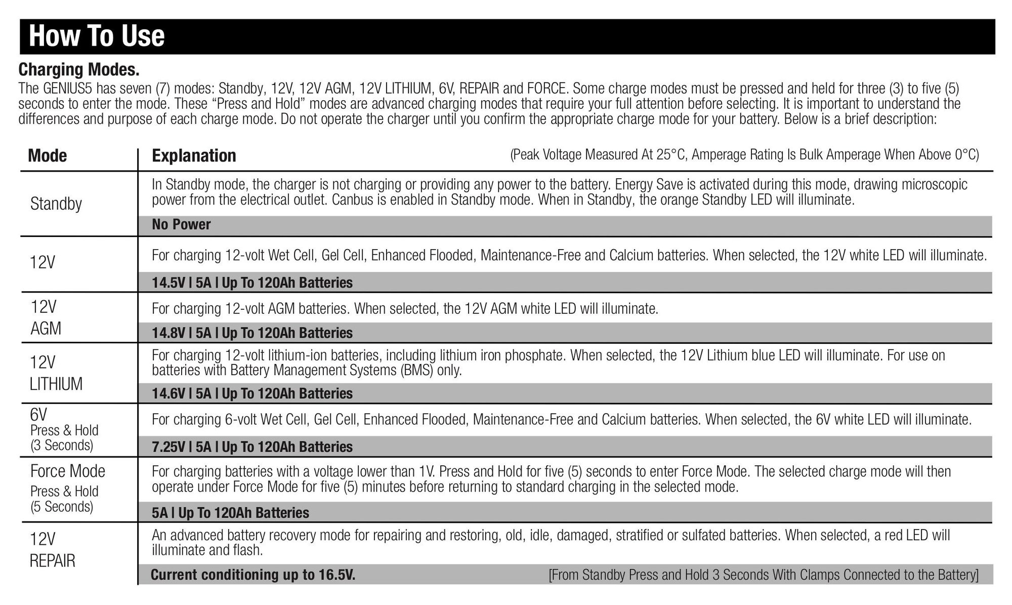

Flooded cell and AGM batteries have different charge voltages and currents for optimal charging. Using the wrong setting on a small maintainer isn't likely to be lethal, and might not even matter. I have a 1A Battery Tender brand maintainer and also a Napa 1A maintainer I use on my tractor, UTV, and other non-automobile contraptions. Both are spec'd as FC/AGM compatbile, although neither has specific mode settings like the Noco does.

It seems that @streborx may have given me the answer. A different mode needs to be selected on my NOCO charger for AGM batteries. I need to try that. 🙂
