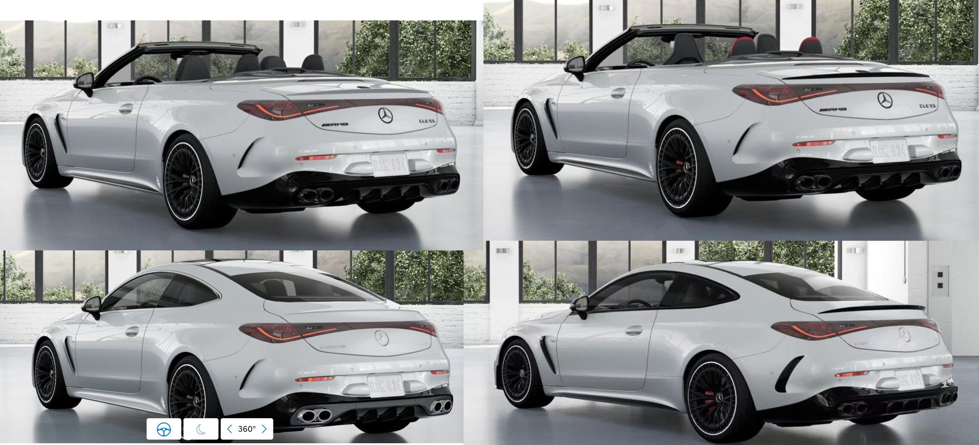

So I messaged the ebay seller, he said that it only fits a coupe, not a convertible, so I looked into it. It appears that the non-Studio package 53 coupe has a very small spoiler but the studio package spoiler on the Coupe is larger. However, on the Convertible, it appears that the spoilers are the same size with the Studio package spoiler just being black instead of body color, but not any difference in size.
In the picture, non-Studio on the left, Studio on the right.
ah damn i forgot you have the CV! - you seen any other options?

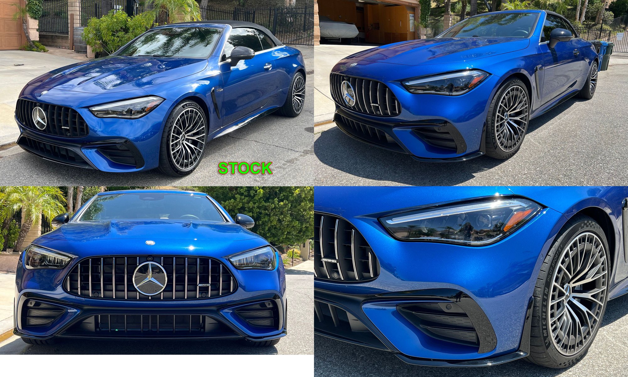

Installed the front spoiler "flaps" from the Performance Studio package. Subtle but I think it looks good.

Looks good. Did you install it yourself?

Thank you!
Yes, I installed it myself. It needs 5 or 6 screws on the bottom and 2 or 3 screws on the vertical part. The bottom was very easy, but in order to screw the vertical parts in you have to drill holes and you have no idea where to drill. Once the bottom is securely screwed in, the vertical parts stay in place for the most part, I used some 3M tape and it appears to be pretty solid, so far anyway.

So there were already predrilled holes at the bottom of the car? I'm thinking about doing this myself too

No, I just used a combo of 3M tape and blue painters tape to hold it in place, then used self tapping screws and with a drill/impact driver pushed a bit while screwing them in and they make their own hole. Just be careful not to overtighten them as it's just the "plastic" bumper cover you're screwing them into.

This looks great, maybe sometime this year I'll get to adding mine 😁. I also have the rear blades, did you do those also? They seem to be more of a pain in the *** to install.
