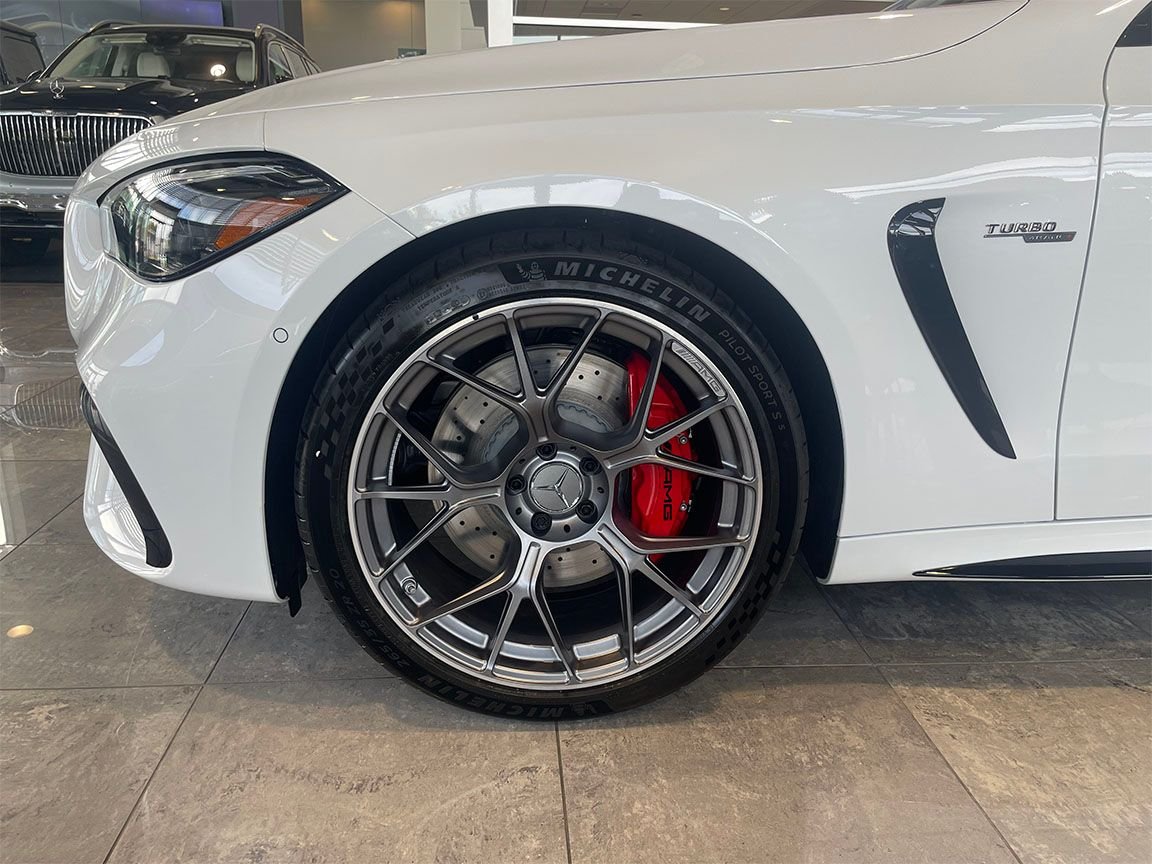

While not as obvious as other examples such as the one you provided, the CLE53 optional "composite rotors" as specified by MBZ appear to be two piece construction. The grayish hat is likely a forged aluminum alloy affixed to an iron or high carbon steel disc. Not sure how the two are joined, have seen similar two piece rotors on other makes/models.
Not sure what you are addressing there. The pictures you posted are not of the composite rotors. The composite rotors are 2-piece rotors, with the hat and ring separated by pins.
Snapped a quickie iPhone pic on delivery of the 2025 CLE53 - might be a slight improvement over the configurator image.
Edit/Add: Ran it past the xAI chatbot for an explanation:
___________________
"For Mercedes-AMG models like your CLE53, the joining method for the composite rotors (aluminum hat with cast-iron or high-carbon steel friction ring) is a specialized casting process rather than external bolts or pins. Specifically, the forged aluminum hat features internal projections or "teeth" around its outer edge, and the cast-iron ring is formed directly around these during a high-speed spinning casting procedure. This creates a mechanically interlocked bond without welding (which is challenging between aluminum and iron due to differing melting points and expansion rates), ensuring the assembly can handle thermal stresses while minimizing heat transfer to the hub.
The lack of visible fasteners in your photo is by design—the integration happens internally during manufacturing, resulting in a seamless appearance from the outside, with no protruding bolts or rivets like on some BMW or aftermarket rotors. This "cast-in-place" approach also enhances durability, reduces vibration, and contributes to the rotor's floating characteristics for better performance under repeated hard braking."

I believe that's just a zinc coating. Proper 2-piece rotors have aluminum hats to save weight. Aluminum isn't gray and doesn't need any coating, but single piece rotors need coating on the hat so it doesn't start to rust. Pretty sure those are single piece rotors you have there and the rest is probably marketing.
The other type of 2-piece rotors are the full-floating rotors. Those are attached to the hat using springs, so they can expand laterally. Those are also easily recognized by the screws that hold the springs together and attach the floating ring to the hat. The ones I've posted above are known as semi-floating. I replaced those with full-floating Brembos on my C63S Coupe.

Aluminum where exposed to such conditions does indeed need coating or passivation to prevent corrosion.
As to the grayish color - a further response:
"The grayish color of the aluminum alloy hat on two-piece brake rotors, such as those in the Mercedes-AMG CLE 53's Dynamic Plus Package, is primarily due to the anodizing process applied during manufacturing. Anodizing creates a durable, corrosion-resistant oxide layer on the aluminum surface through an electrochemical treatment, which naturally results in a matte or frosted gray appearance without added dyes (though pigments can sometimes enhance the gray tone for consistency or aesthetics). This finish protects against oxidation, heat-induced discoloration, and environmental wear while maintaining the lightweight benefits of aluminum."
It's difficult to imagine that MBZ would specify the brake rotors as "composite construction" solely as a marketing ploy.

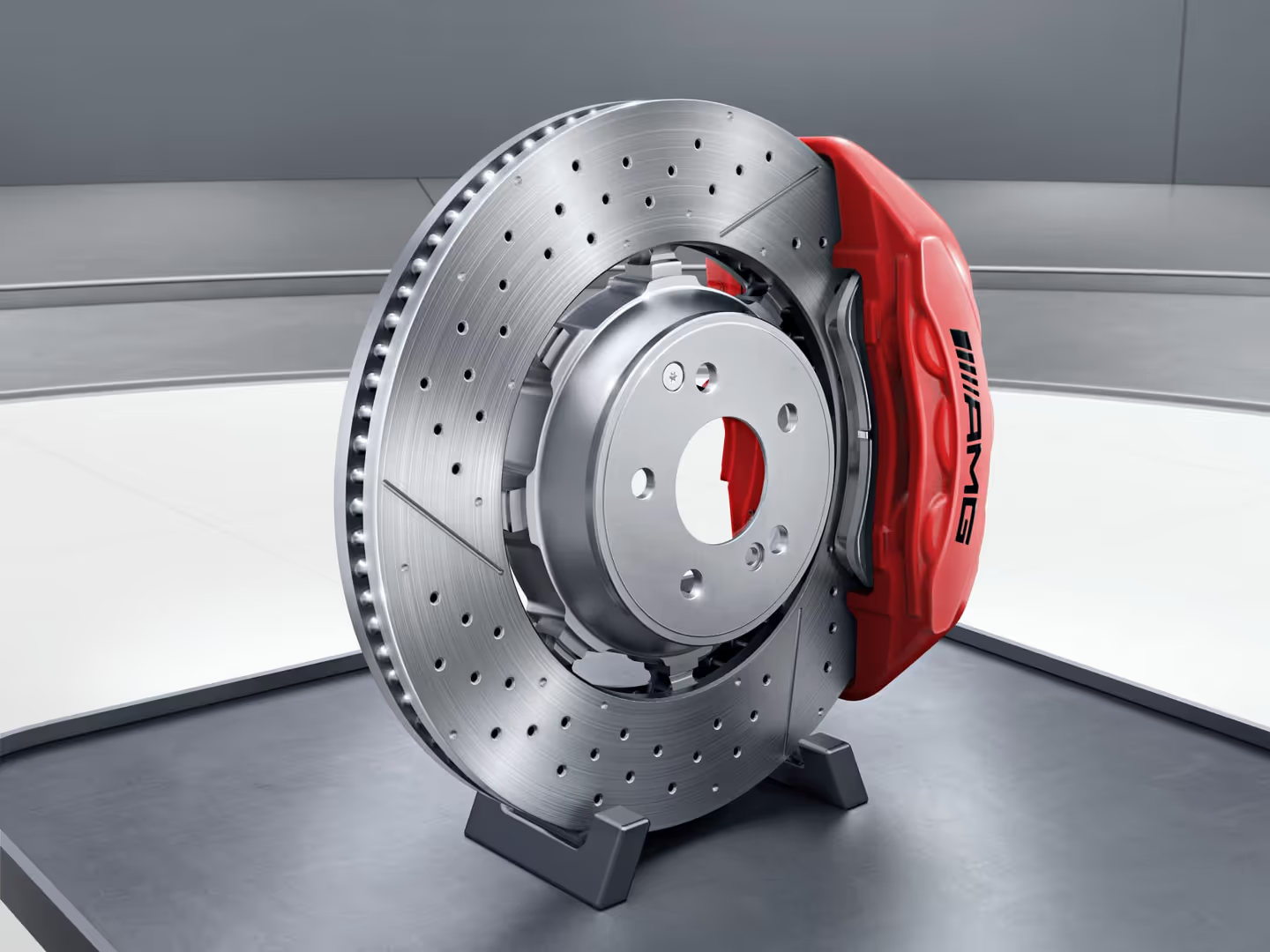

Regardless of the online explanations, I have been puzzled by the homologous appearance of the "composite" brake rotor - and after researching this further undertook a closer inspection. Using a magnet on both the friction disc and then the rotor hat proved that the latter is not a non-ferrous aluminum alloy as expected.
It appears that MBZ may have used a cast iron friction ring press-fitted to a sheet steel hat. Therefore they can technically term them as "composite" since they use two different materials in the two-piece assembly. While they are not "single piece rotors" they are also not aluminum hat two-piece rotors consistent with the term "composite" where applied to other AMG vehicles. So yes indeed - there is a definite marketing component.

Yes, it is interesting that the hat has "teeth". I haven't really seen this before, but it fits your press fit theory to make sure the hat and ring don't slip against each other.
