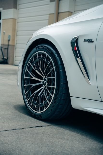

Originally Posted by furio_CLE53
Hey man I`m pretty happy with stock ones with dynamic package (red calipers) EBC yellow stuff you could try I guess
Beautiful car but I'm sorry, I hate those wheels. I have those wheels and they are a ***** to clean. Every
time I see them, I feel the same reaction.
I have the same ones in black, and can confirm, a HUGE pain to clean lol. They look brown half the time because of brake dust lol
